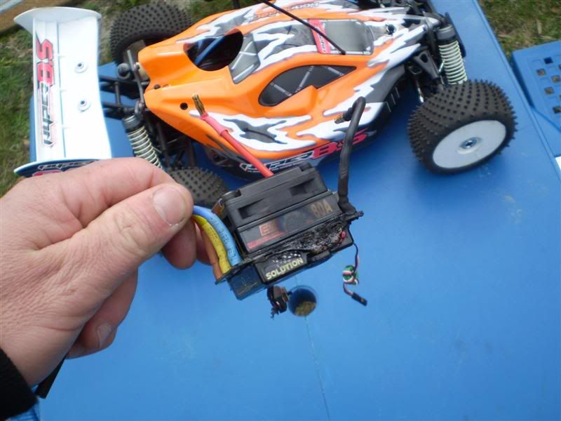

I made my madian 1/8 electric race on the weekend
using a HW 80a on 4s with a medusa 1600 kv in a hyper 8.5 i had it gear on a 15t pinon.
the track was grass and quite short, very tight .
I was racing with the nitros the heats where 7 mins
the first heat i did 13 laps and won by 2 laps ! ( took 3200 mah to recharge the lipo)
and in the second heat, i was one the first lap the car stop dead, the marshall brought the car back to the drives stand, at this point there was lot of smoke and flames .
Not sure why it when up ?
today i have got a 150A and i have order a tekin rx8 also, so hopefully i can have some better luck with them

I am sure you have probably read through, but was anything changed on the esc settings other than cutoff voltage.
yea i dropped the timing down to 7.5, lower the brakes and also the punch setting ......
all my testing was done with a 9XL motor and it was savage, so all that tone it down to driveable levels .

How low did you set the punch? Many have burned the EZRun ESCs by running the timing too low (seems like 7.5* and lower may make it puff) and punch too low (anywhere near 0-zero punch). The stock settings for timing and punch work great and I don't think you would benefit much in terms of performance, runtime, or heat by altering them. For the 150A coming, I'd recommend not changing the stock settings by much...maybe 1 or 2 each direction, but not more than that.

Zetor, mine burned up on its second run too.
I only changed timing to 7.5deg, after reading about the dangers of low punch setting.
Your lucky nothing else burned up when it went off, mine did quite a bit of damage.
It sucks because you soften settings to be careful and nice to your car, not realizing
it could turn it into a time-bomb. I will definately not touch anything other than cutoff
voltage when I get mine back, and will run it without the new body on till I am sure
it will be OK.

The only sensitive settings are punch and timing. Everything else is fine to adjust. And there hasn't any more issues than other brands bit customer service IS different than US brands. For the money I still think HW ESCs and even motors are a great value for the performance they deliver. And HW makes BL systems for quite a few well known US brands.

09.13.2009, 10:41 PM
