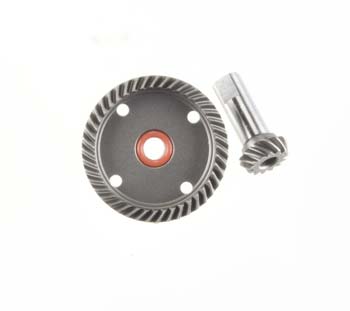

Originally Posted by its me View Post
here you go George and for any others that have not seen the inside of a LST/muggy/8T diff.
very nice helical cut ring and pinnion
some have asked and yes the diffs are very very strong, my twin motor has yet to kill one yet.
People do say they are strong
Just thought I would let people know there are real Helical gears available.
Hmm..... again try it for your self, the gear has a slight helical cut... BTW do some reading on helical cut gears with out runners, I wouldnt want to use a helical cut gear like hot boddies/ kyosho/ because of side load...
As a 4 wheeler , People always break their 5/29 gears before people break 4/88's
the reason is more tooth contact
Same thing here for the Helical ,more angle provides more contact, more gears evenly distribute the load, not just one tooth at a time.
Not my thread , or would supply name part numbers. It was just an example
Good day
Helical does have a problem though, it loads the pinion races perpendicular to their rotation. As the helical gear rotates along the spur it is constantly trying to force itself away from the spur. People with high torque setups would have issues with the inner pinion bearing coming apart due to this load. A thrust bearing would be a good item to add, but space is usually limited in that area...
Good day
Again Since were using real world examples, what type of gears do indy cars use (straight cut) What kind of gears do non snycro trans use.... strait cut as well.. Reason for that is weight/strength, helical offer quieter operation..
Back to rc application... many ON this forum have proved that the side loading of the helical gears utterly destroy the inner bearing..
