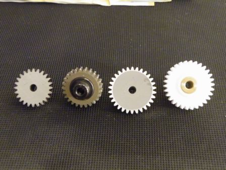

Originally Posted by Rivermaxx View Post
Neil we are talking about mod1 gears not .8 or 32p gears. A 25 tooth mod 1 is bigger than a 27 tooth .8 or 32p. Bigger than 25 tooth mod 1 steel gear is almost non existant.
For your viewing pleasure................
24t, 25t on 2 speed adaptor, 30t, 30t

  (#56)
speedracer1129
Posts: 185
Location: Miami, FL
08.31.2009, 10:32 PM
AND BEFORE THE QUESTION ARRISES.................
they ARE for sale!! I am no longer doing anything fast. I will let you new speed guys have the fun!!! Here is what I have left:
1- 24T 5mm
1- 25T w/2 speed adaptor
1- 30T 5mm
2- 30T 5mm Acetyl
1- 30T 6mm Acetyl
FS: Medusa 80mm 1600kv 5mm
FS: Mega 22/30 3 1270kv 5mm
FS: Datalogger V3 150amp version
Will the plastic 30 tooth work with brushless power since the aluminum gear is the wrong degree pressure angle ?
I ran the plastics for 1 to 1 ratio on a 10S truggy and had no problems with them. Ofcourse, your trigger finger might be more anxious than mine........
