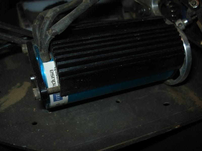

Mozzy
Mozzy's Avatar
Posts: 280
09.10.2009, 11:26 AM
Wow, I haven't been on here for ages! Helps to have a PC that works too.
Here's my Medusa.
Will I have trouble with the endbell separating from the can?
