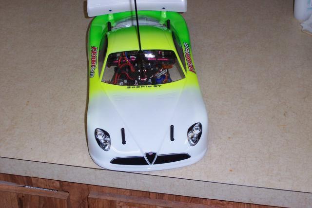

Well i did my first airbrush paint job. I think it looks pretty good for the first one . I dont know how to post pics . So if someone could host or post it for me please let me know . I used fascolor water based paint . also to anyone that uses fascolor paint . what do you use to thin the paint, & how much do you thin it ?. I used the fascolor thinner . but i've heard people use windex or alchol as well .

Here are the pics . Thank's for the help bdebde . Rooter you should need a hose & that should be it . My paint cost me $4.29 a bottle .

Ross no not the entire bottle . Depending on the amount of a certin color . I mixed 3 table spoons of paint to 1 to 1 1/2 table spoons of thinner . I have a lot of paint left . The cup on my gun holds 7cc of paint . I filled my cup about 2 times for the green & yellow . I filled the cup maybe 3 times for the white , because the white coverd the whole body plus wing .
