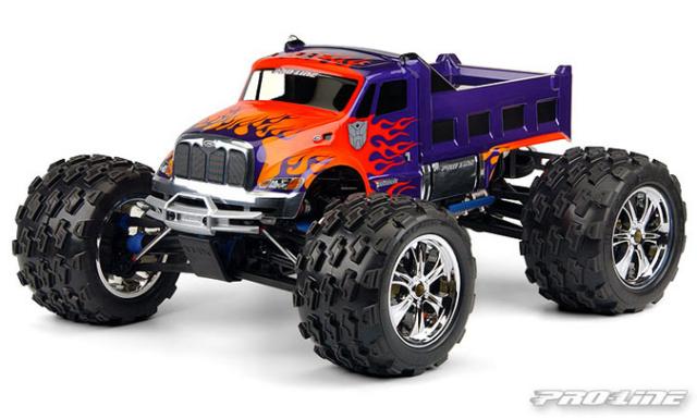

Body suggestion if I may, What kid doesn't like a big honking dump truck ?

I looked at the dump truck and almost went for it. I showed Gabriel some pics of the bodies I was looking at and he liked the big honkin' pick up truck.
