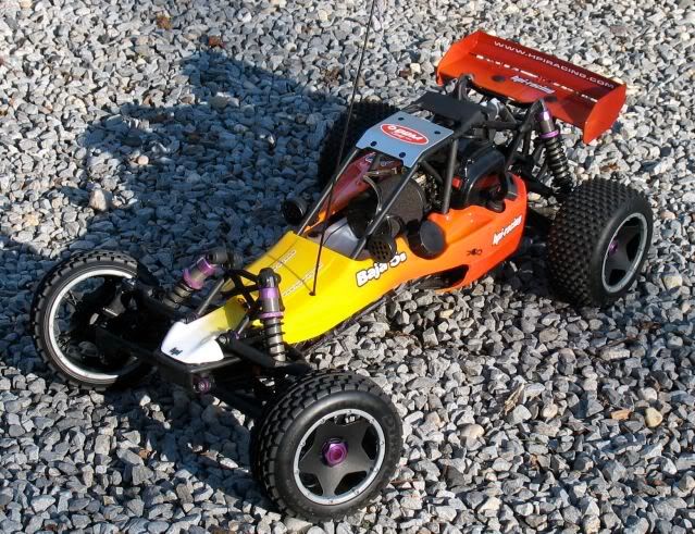

Thank you one and all for all the help. I installed the Futaba servo and have metal gears on order. The Buggy seems to be running just fine. Would never have been able to get her going without your help THANKS! Here's a video of the Buggy without body panels which I am still painting.

Sweet! Large scalers RULE, once you go big you don't go back.

Thanks for all your help gentleman. The Baja is painted and the steering servo is fixed!
