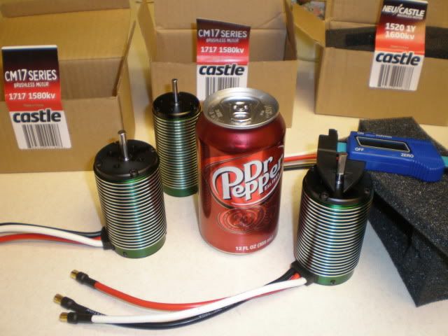

I'm curious why they would put a 6mm shaft on it, they are basically building it for US and other future RC-M nut jobs and we all run 5mm shafts. If it has something to do with a helicopter needing a 6mm shaft or something, put that shaft on the Heli version with the ground down fins and give us the 5mm shaft! I'm not going to pitch a huge fit over it because I bought the motor before there was anything really known about it (said 5mm shaft on the chart, but it wasn't the only error) because I had faith in CC that they wouldn't do something so stupid as to give us the shaft like this.

My main issue is that I have a ton of 5mm bore pinions, and I only buy 5mm bore pinions cause I only buy motors with 5mm shafts...
I guess this 1717 motor can go in the 1/7 scale on road project I have, I was going to use a kb45 xl motor, and had mike enlarge the center of his 2 speed adapter to 6mm to fit that shaft. This has to have a custom made motor mount anyways... Sucks that I cannot use it with the lst (although I could if I use the 2speed adapter with the losi tin gears...)
Just a bit miffed that the info was wrong... Not much I can do about it now, my CC was charged yesterday and I am sure I will see the motor next week.

Got mine today. Thing is massive!
Century Heli has 6mm mod 1 pinions in 9-11 teeth. Apparently pretty common for heli applications?

Sorry guys -- we just realized that the car versions of the 1717 were incorrectly listed as having a 5mm shaft.
About the 45000 RPM limit -- at 45000 RPM the magnets have a centripetal force of over 1500lbs/sq in on them (about 30,000 Gs -- seriously...) -- that's about the physical limit of the kevlar reinforced magnet structure. To go any higher, we would need to get a stronger material than Neo/iron/boron magnets. :(
We just don't know (yet) how to hold the structure together at above 30,000 Gs.
Patrick del Castillo
President, Principle Engineer
