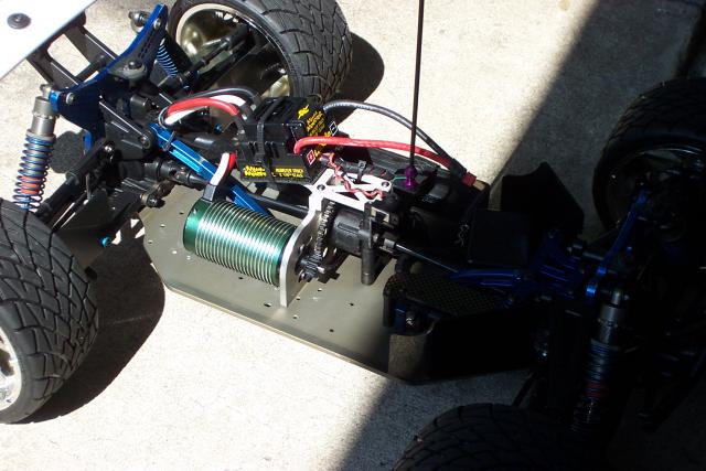

I mount mine like this . I know this is a truggy. but this is how i mounted my MM in my jammin buggy. In stead of it being angled . You could make it were it comes off the toplate then drops down about 1/2 inch . then make it extend towards the back so the MMM will fit .
