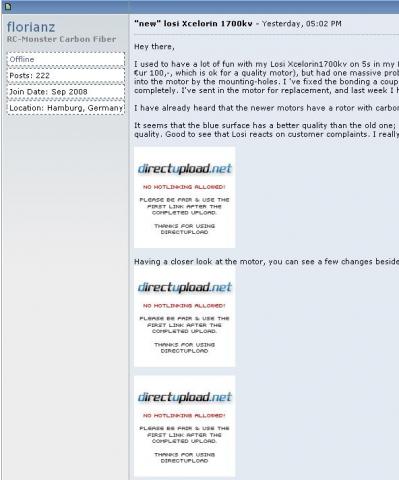

How can I see your pics? I am really interested in the new motor.

the pics don't work?? strange, i will choose an other pic upload

so I try an other upload for the pics
kindly let me know if these pics work now.

Wow, that thing is CRAZY. Are those 8mm bearings? and the shaft is 8mm? , it's the biggest I've seen in 1/8 motors.
PS: this was what it looked like on my computer. Thanks for the awesome pics.
