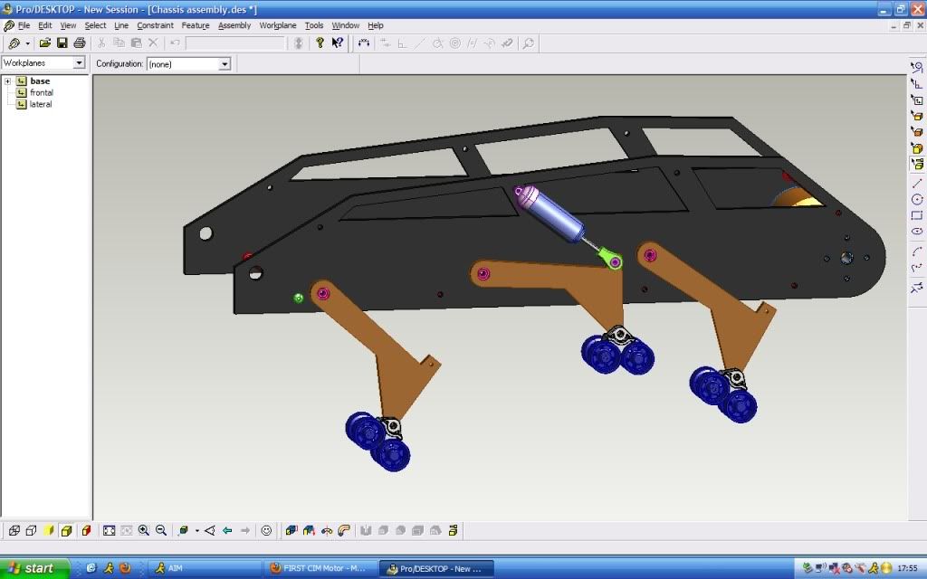

Thus comes the extra cost.. I have the standard boogies on home made suspension arms to cut down on cost..

More Progress..
Designed an 8th scale buggy front shock for the suspension
Edit, Crap I just realized that the upper shock mount interferes with the track routing... Will post updated pics when i remodel the chassis plates
