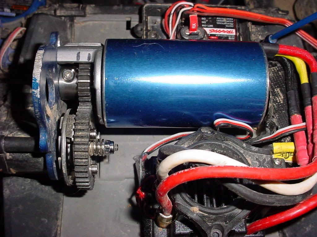

I just acquired a couple of 25 tooth Mod 1 gears with the 6mm ID.
This NEW KB45 10 XL had just been sitting around waiting for some action.
Here is my proposed setup now:
E Revo
MMM
Apogee Limn 3800mah 6S or 6S Turnigy 5000mah
KB45 10XL geared 25/40 using Mod 1 gears
Now the only thing I'm missing is those m4 screws to mount the motor with.
Where can I find those pesky things?
How well will this setup work?
  (#58)
scarletboa
scarletboa's Avatar
Posts: 929
Join Date: Mar 2009
Location: Las Vegas NV
01.29.2010, 04:45 PM
i got my m4 screws from ace hardware. not too hard to find......
  (#59)
sikeston34m
sikeston34m's Avatar
Posts: 2,085
01.29.2010, 08:58 PM
Today, I ventured out into the snow and went to the local Lowes. I couldn't find the hex head countersunk m4 screws, but they did have some phillips head. So I got those.
After much work on the aluminum motor mount in the E Revo, things began to fit.
The 25 tooth Mod 1 pinion needed about 1/8" of metal removed to clear the teeth with the motor in position.
This motor is HUGE! KB45 10XL 1200kv
Geared 25/40.
This is geared for speeds like:
4S = 36 mph
5S = 45 mph
6S = 55 mph
I have a feeling it will work well with anything from 4S to 6S, but we'll have to see about that.
Everything fit tight, but it did fit like a glove.
Check this out!
