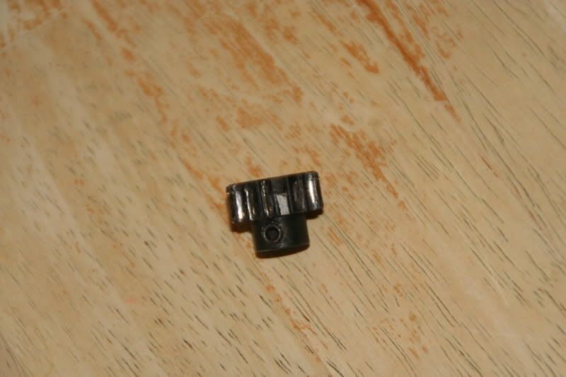

i never had much of a problem with pinions falling off until today. i got my rc-m motor mount and pinion for my truggy and i managed 2 30 sec. runs. each time, the pinion fell off. also, the teeth are already looking kinda sharp where the pinion and spur made contact. the mesh was good and it is a rc-m pinion. i have had pinions wear away slowly and none that have issues with staying on the shaft.
the rc-m pinion i ordered is decaying very fast. only ~1 min. of runtime and already the teeth are sharp. the only other time this has happened to me is when i used a stainless, non-hardened pinion. it's like my brand new rc-m pinion isn't even the least bit hardened. maybe it's just a fluke?
IDk. I once got a 14T RCM pinion that lasted less than a day. Perhaps they didn't harden properly. Perhaps contact Mike or just bite the bullet on a new one.
I use green locktite onthe shaft and blue on the screws. Green is for shafts & bearings, and it does hold the pinion on very tight.
03.05.2010, 03:34 PM
Yeah, I would definitely contact Mike. Sounds like the heat treatment wasn't done right for whatever reason.

well, i was able to get some runtime in today and the pinion stayed on after using blue loctite, but there were other problems...
the teeth wore even more and a tooth even broke off. i was running in fairly slick grass when it happened and the mesh was fine. i checked every other possible cause and everything was fine except for the gear. the motor mount and motor had no movement or play and everything else was fine. maybe the pinion gear was over-hardened. i sent mike a pm with the picture. hopefully, that will be enough to get a replacement without sending it in.

03.07.2010, 06:10 PM
He should be cool with that- sometimes the pinions get overhardend or underhardened, so he's happy to replace them.

mike still hasn't replied to the pm or the e-mail i sent him. i included the picture of the pinion gear in the pm.
