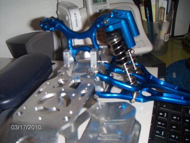

George I was thinking of making my build nice and clean to unsure of what color scheme to use or motors guess it is going to take some time these are my parts mostly unlimited engineering and some blue hardcore, but I am looking at that mount for sure,Gotta thank plettenburg and billystrucks , these are some pics, Definitely going to be asking questions
Nice build Swift. I hope you didn't pay much for those setbacks because they are not the real UE setbacks. I'm sorry to inform you this.
I know the difference since I got both real and fake setbacks (got burned on it 2 years ago).

I think I made the purchase but I wanted setback arms not worried if it was ue for that part (setback) I have the arms in hardcore also not setback just wide

Yea you have to be careful who you purchase UE parts from. Make sure if you buy from anyone that you get clarification as to whether or not the parts are actually genuine UE parts or counterfeits. The best way is to buy them from the UE store or at least from reputable people here on the UE forum. You can always come here and ask for advice on a certain pruchase and someone here can verify its authenticity. Dealing with certain folks on the Bay is a very risky transaction for sure.
