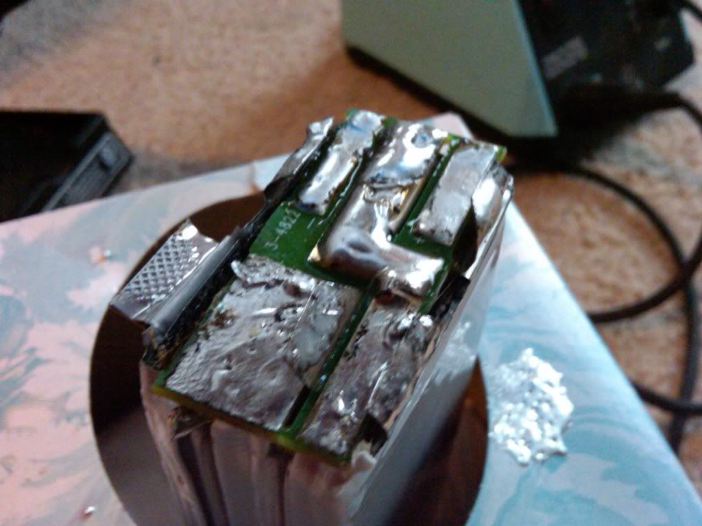

Fixed a lipo For A member here

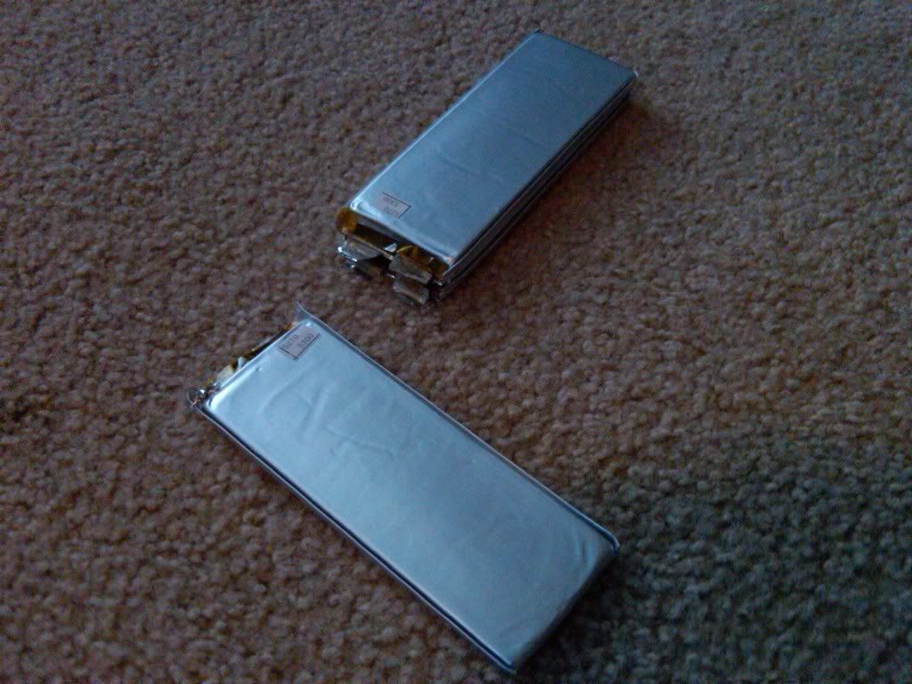

2- 3cell lipos, one pack had a bad cell

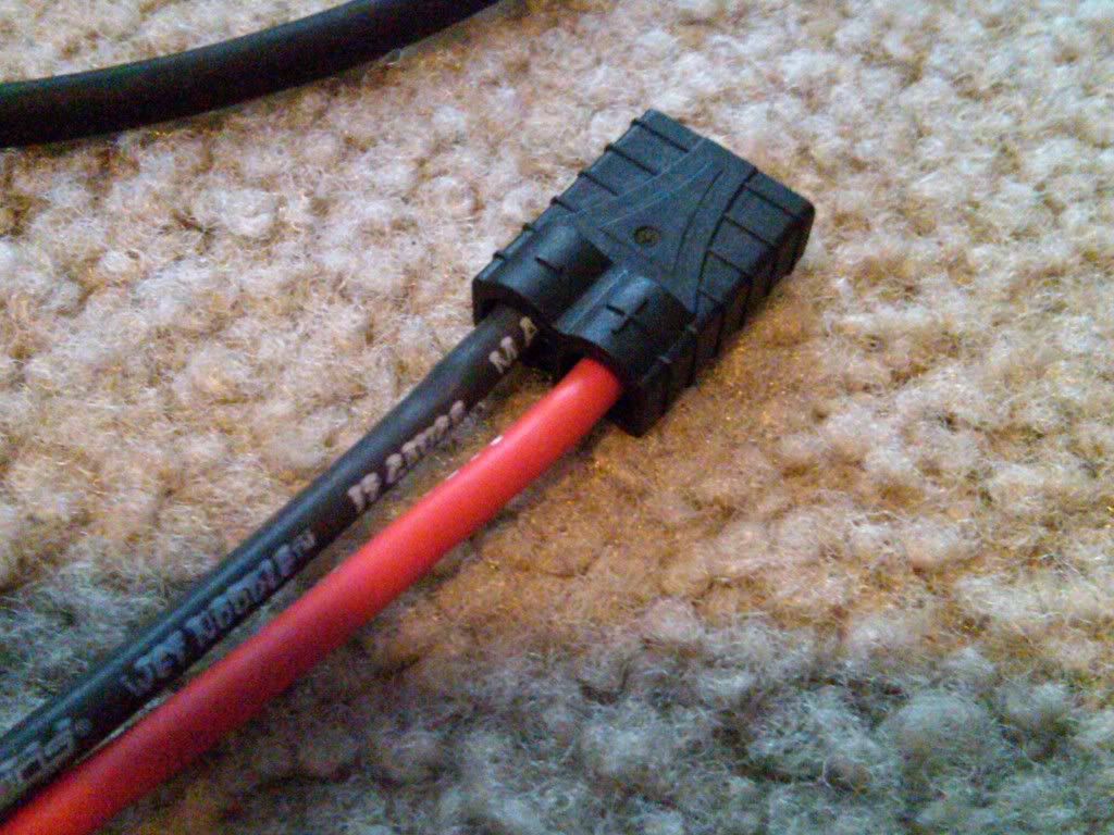

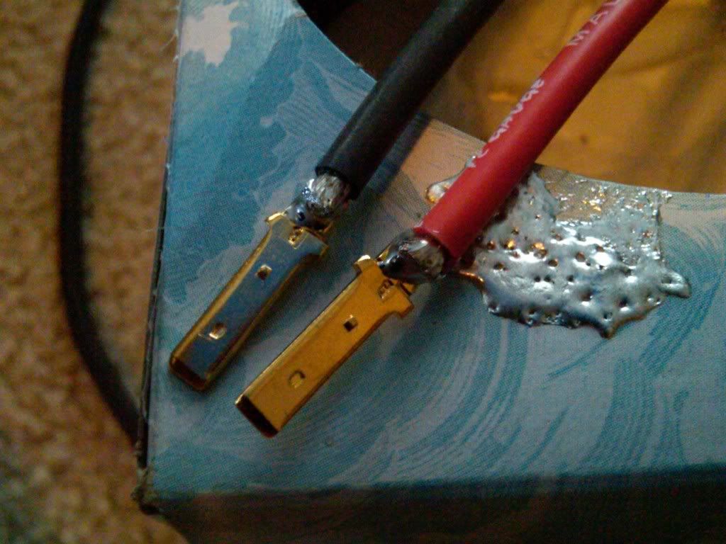

Made 2 2cell lipos, reomoved PCB Installed 12 ga wire, traxxas connectors and 2s balance taps.

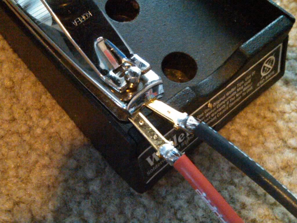

I wasnt in my normal workshop but the finished product was top notch if i do say so myself.. Note the tissue box holding the lipos, and the nail clippers holding the traxxas contact plates, i had to get creative!

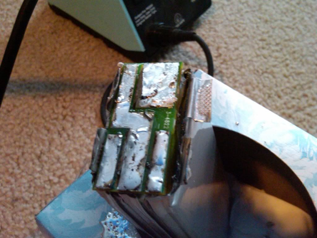

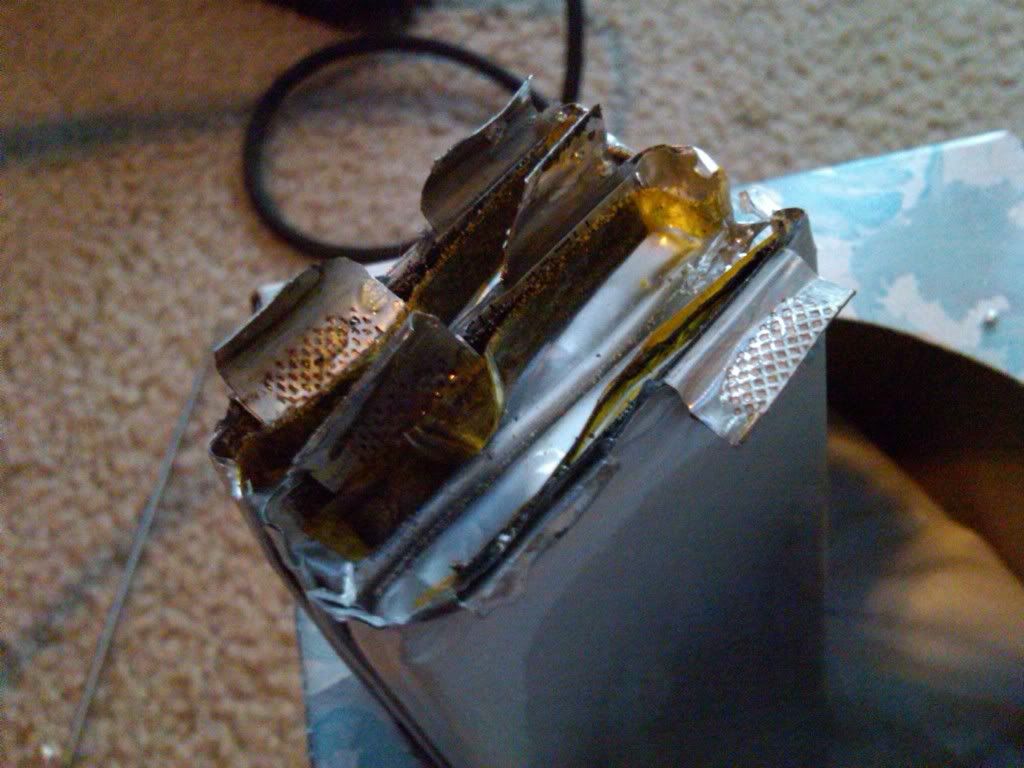

Starting desolder tabs
Pcb Board removed
Cell removed
Traxxas connectors
Finished product

Looks good BB16, Thank for the pics and now I know these cells can be easily seperated. I have a buddys HC 5s I need to remove a cell from to salvage to a 4s pack.
The older packs are directly glued together, adhesive remover or Lighter fluid is needed to break down the adhesive or you will stretch the cell cases. This is a newer one and it has plastic separators between the cells

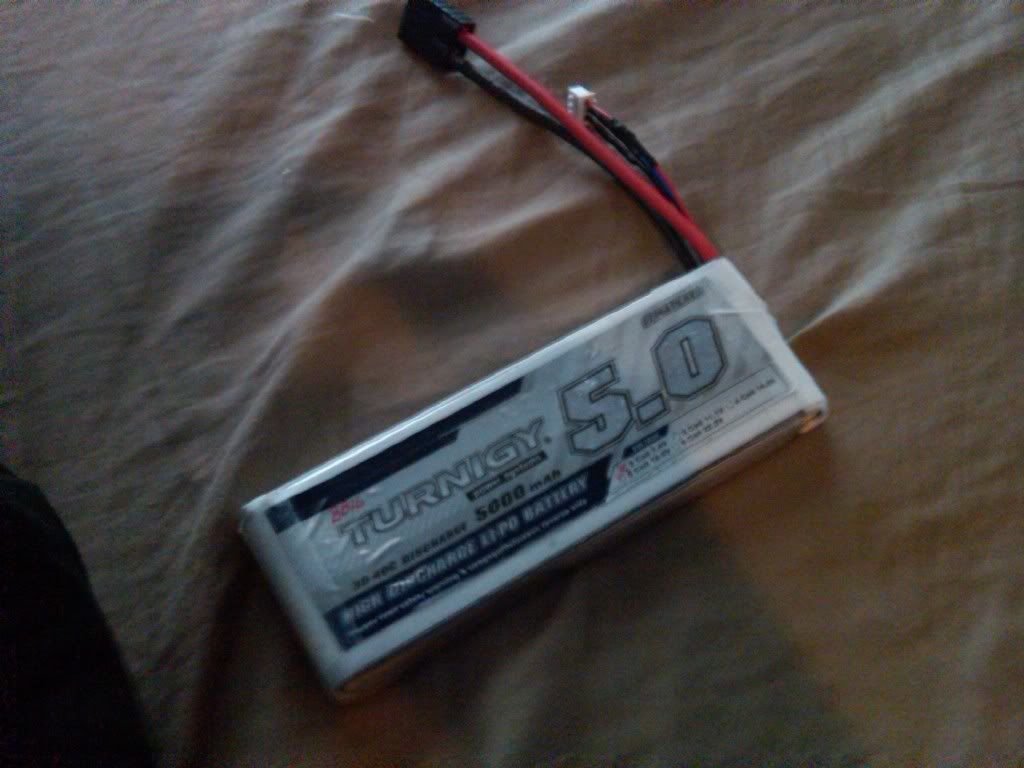

Something is wrong with my 4s2p 8000. It's been losing some punch lately???
Ben how do you remove all that solder on the PCB/tabs?
I cant give out trade secrets :)
Wow those must be the new MaxAmps super duper extra capacity lipos because they're so big ???
No it was a TrueRC 10c purple brick.

A solder sucker, or copper braidingis useful- melt the solder then 'extract' it either item to leave as little as possible, ready for new joints to be made. Looking at that picture though it appars nearly half the cells have puffed- I'd say that pak cant be saved, or isnt worth saving given the age/ spec.
Thats not my method but whatever gets the job done
