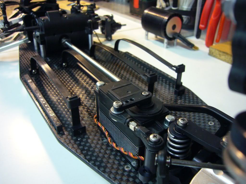

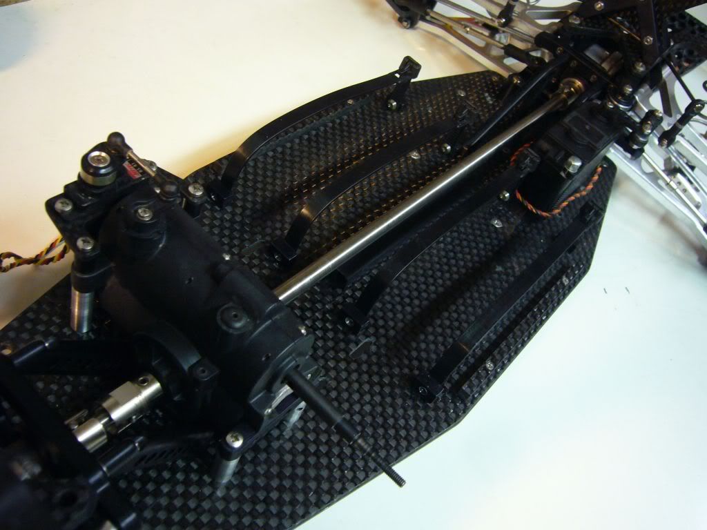

Almost done
Some srews are replaced by M4
even the balance point is on the right place I think...
All straight, many black parts

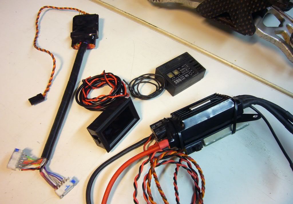

Temp-Display on receiver and in the middel the LiFeDiMatic
The ECS whit temperature sensor. Under it the Ultimate-BEC

Damn that is a beautiful truck. How rigid is that chassis with the cage? In some pics it doesnt look like it has any bracing lick the truggy chassis.
Also, a stretch, but have you thought about doing a limited production?

@ rc4x4nut - Yes I think about a conversion kit but not full. Only for the normal Nitro-LSTīs. There are so many things I arranged in the gear box. The motor mount is so complex. I donīt want to build it again.
