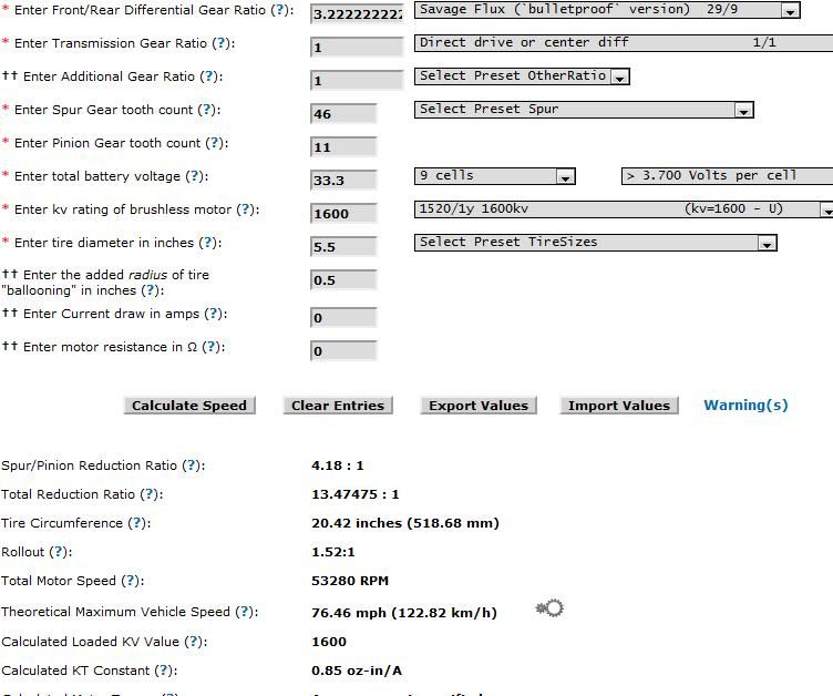

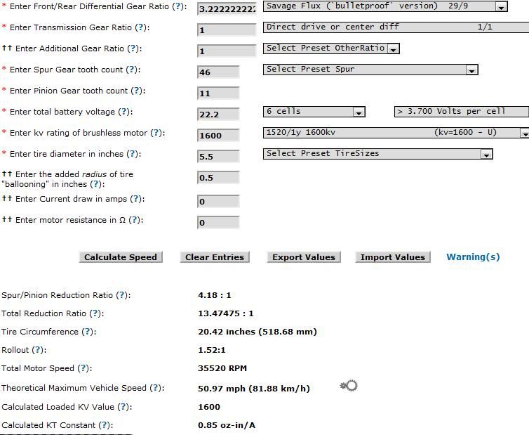

Im just trying to see how my gearing would look. Right now with my current setup and tranny on my savage... im geared for 53mph. I have decided to gear for 50mph with the CD Setup... DOes this look correct? Meaning i will run 46/11? (im not used to running such small spurs. :) )
If that is correct... when i buy the RCM mount from mike, i will pick up an 11t spur as well....

11 tooth pinion I think you ment, along with the spur. Those numbers look good, though ~70mph may be difficult in such a large vehicle, even with 9s lipo for grunt- aerodynamic issues will be killer.
