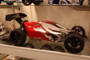

Heres a pic of the Redcat 1/5 Brushless 4wd Buggy thats in the works. Testing has already began, and I should have a proto in the coming months. I dont have alot of specifics like weight, battery compartment size or anything just yet. Roller weight should be in the 5-6kg range at most, I just hope they offer rollers to everyone. I PMed Patrick at CC about getting the mounting dimensions of the MMMXL so I could possibly have the buggy prepared for it to drop right in.
If you want more pics I can post them.
You guys can have the wheelies, id rather have on track performance :)

Badass, I want one. Looks like my lst just bigger. I am sure whith normal driving it will do fine, but have the power to do the fun tricks and stunts. I wonder what power system they are using...

Honestly you dont wanna know....HW 150a esc on 6s with a 1050kv motor...geared to the moon(55mph by the speed calc) so they fried it! Im begging them to sell it as a roller, considering ESC mounting, motor mounting and all that is easy as pie. Not to mention 90% of the people interested will already have the lipos, charger, motor, and ESC in mind that they wanna use, and just chuck the RTR stuff.

its all in how you drive it , those guys were just grabbing handfuls of throttle to show off we can all do that, i commend them though would like to see the price tag, i think i am going to do a 1/6 scale of my e-maxx why not everybody else is going big
