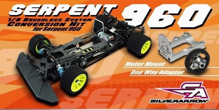

The Speed Passion mount is made to accept 36mm diameter motors only, like the one they produce, basically a 540XL Feigao. Looks like it would be pretty difficult to make that mount work with a Castle motor. The way the mount is made has the motor is resting in the lower "cradle" along with being attached with the standard mounting screws in the front of the can.

Judging by the pic simplechamp posted I think the mount can be modded to work. Shaving cradle and the fins of the motor where it interfere is one way to go. The other would be to elongate the holes in the mount to move the motor up.
You could also unscrew the motor mounting plate from the mount and make a new one that raises the motor up. Use the old plate as a template and move the bottom screws (the ones that attach the plate to the mount) down 3-4mm to raise the motor up.
