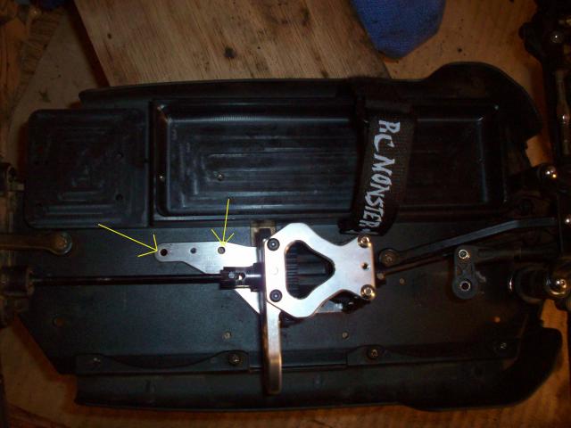

I have the conversion kit and have a question. There are two holes in the bottom aluminum plate that goes on the chassis. There are two holes in the plate that line up with holes in the chassis. The holes in the plate are NOT threaded so there is no way to use a screw and the kit did not include bolts. I cannot tell from other peoples pictures if there are screws there or not.
I have marked the attached picture so you can see what I am talking about.
Thanks,

I used a couple of lock nuts there. It's hard to see detail, but here's a view of mine:
  (#562)
