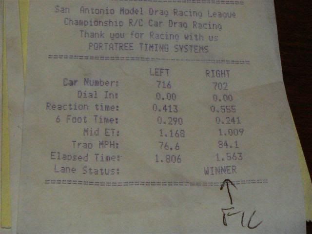

I'd like to add my experiences with the 1406-7700 motor in my 1/10 funny car over the last few weeks.
The first attempt to run this motor was at Autorama 2010 at George R. Brown Convention Center at a RC drag racing exhibition race November 25 - 28, 2010. That didn't go over too well in that the track was way too sticky for any fast numbers. I noticed that this motor has a lot more torque than I anticipated, which meant I had to use wide tires as well as more torque control than I wanted to. The stickyness of the track meant that with the lower available torque start off was sluggish, but the top end was good. The best I could manage was a 1.7s ET.
At this point I decided that further testing at this location was futile and should be continued at the next race in San Antonio, which would be the final race of the 2010 Texas Twister Race Series, held last Saturday (12/11/10). So the car was set up like it was at Autorama: MMM ESC, TP 4200 3S Lipo, weight at 49oz, 4.30:1 gearing, 2.8" tires. This was good for 1.563s @ 84.1mph in the 2nd round of qualifying, and got me the TQ.
It got cold quick after that and ET's didn't go down any further due to low lipo performance in the cold. However, I went on to win the class with 1.6s ET runs in the next few rounds into the finals, where I ran a 1.7s (it got colder still!).
So, here are my thoughts about this motor. Toque monster!!! With the lipo discharge levels that we run, this motor creates gobs and gobs of tire shredding torque with extreme ease. I have to get more familiar with the Torque Limit settings a little more in order to really unleash some fast ET's. One thing that I really like about the motor was how smooth it was when everything was dialed in. That 1.563s pass was so smooth all the way down the track. Now the trick is to keep that smoothness going into faster ET's, which should be no problem as I run it more and more and get a feel for its power characteristics. My attempts will continue next season as we have already closed out 2010 and will post updates as they come.
My thanks and deep gratitude go to Patrick and the awesome folks at Castle for getting me this jewel of a motor to race with.

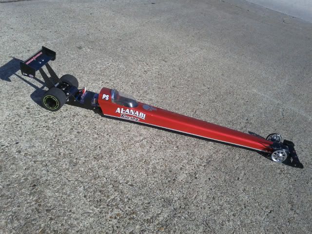

Got a new "testbed" for 2011 Since my other TFD was doing so well, I decided not to use it for testing (don't fix what's not broken) and decided to buy this one for that purpose. Since this is a "sidewinder" chassis, I'll have another parameter (gearing) that I can play with, useful for testing the Castle Creations 1406-7700Kv motor. It's geared 4:1 and has the 1406-7700 already installed along with a Mamba Monster ESC. I just couldn't wait too long without putting it together Without a battery she weighs in at 26.8 oz. I'm also very tempted to use this car as a stepping stone into Extreme in 2011.

Sunny How do you combat the time delay made by the Esc trying to detect rotor position since your running sensorless?
I raced a friends pro mod carwith a 9000kv on 2s and the thing would either leave like a rocketship or stutter back and forth for about a tenth of a second then take off.

I think the most important thing is to have a battery capable of discharging enough current to overcome the initial launch. To that end, the 40C TP packs have proven exceptional (that's all I use for the most part, save for a couple of 50C 2S packs). Also, I use "high start power" as a default (less if the track is slick), which again require good batteries.
Also, tire prep is important. You need to use some Koford, or similar, traction compound which serves two functions at the same time. It lets the car stick to the track on launch and its viscosity lets the tires slip a little, which helps helps the motor "power through" the launch. If you don't put enough of it, the car can stick to the VHT on the track and not move/stutter.
Even through all this, the car sometimes does the "Mamba Shuffle" simply because. For me that happens less than 5% of the time I think.
