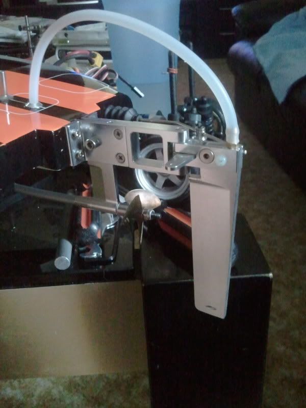

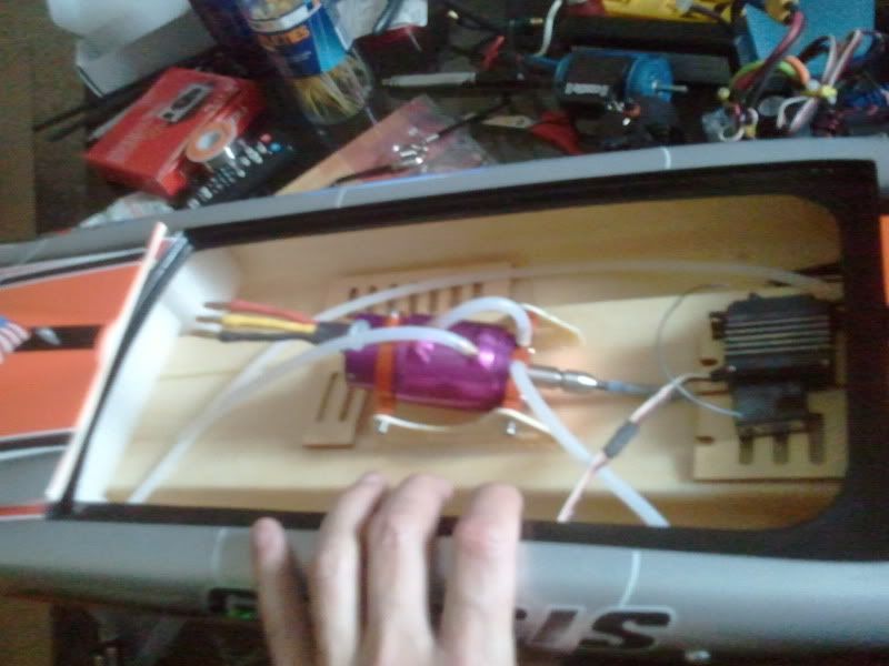

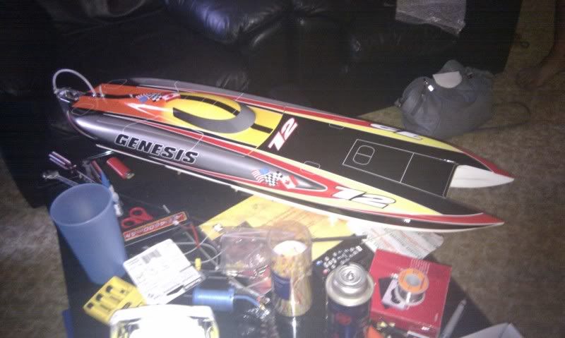

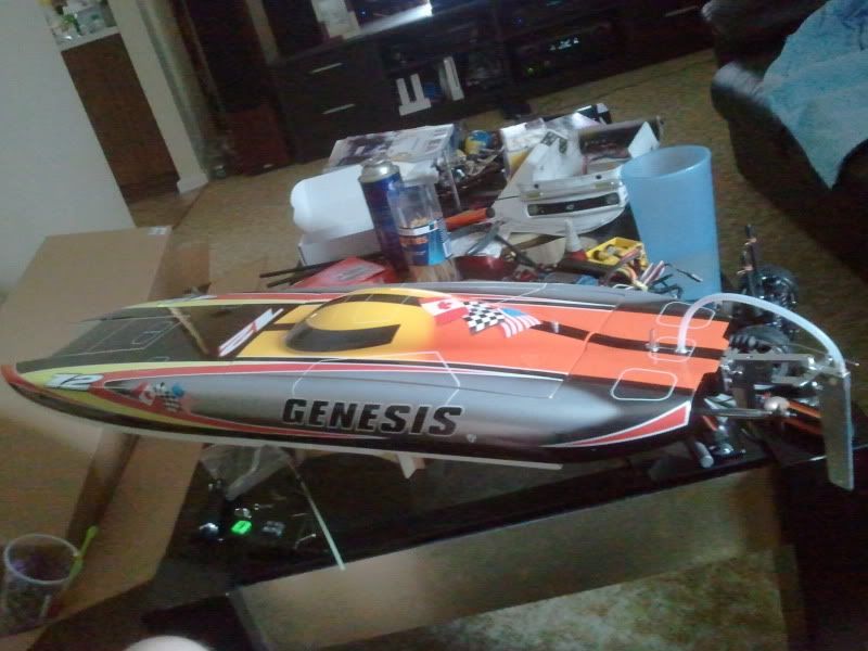

I bought an electric ocean cat 'Genesis', 1045mm overall and came with 2075kv BL motor and running hardware, including plastic prop. I never ran it with that prop as I changed to an Octura X437/3 Blade Beryllium Copper type before it touched the water.
No radio, ESC or batteries came with the hull.
This configuration (ie motor) can only cope with 4S as you will soon see why.
The first run was done with the stock motor (obviously), a Mamba Monster ESC (mainly due to it's auto fan & I never had another ESC that could take 4S) and 2 x 5000mAh 40C 2S 7.4V lipos in series which is a 4S 14.8V configuration. Which ran perfectly, however, was a tad slow and had hot packs afterward. I think 2 x 4S 4000-5000mAh 40C in parallel would be very good for this setup.

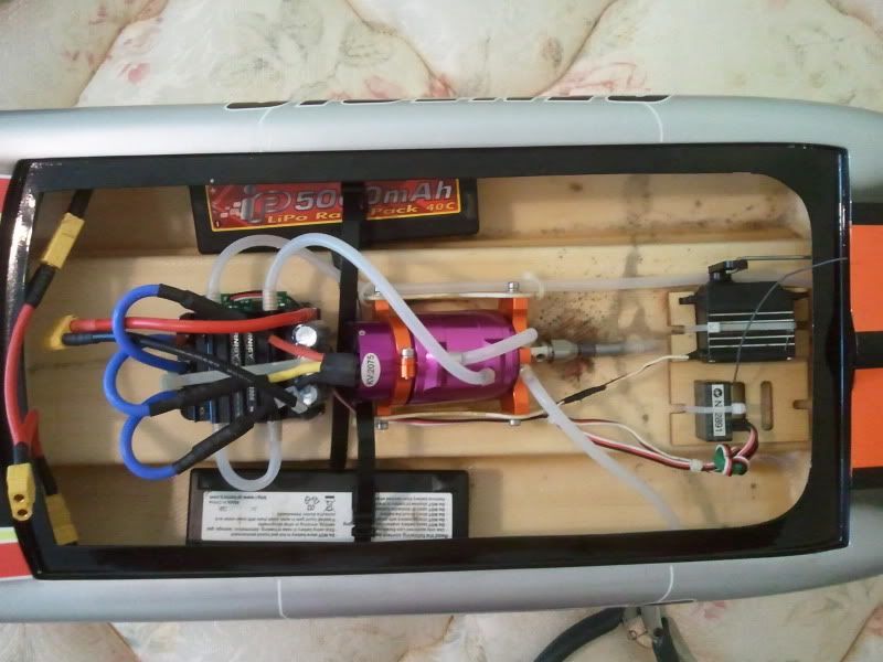

The third run was with a new motor, the one chosen began it's life in my Hong Nor BL converted truggy for about 2mths running happily on 5S.

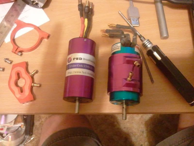

I pondered my overheated motors demise and kept staring at these 2 Medusa Industries powerhouse motors glaring at me with their bright blue hue. Both were a 36mm diameter can, both 2000kv, but one was 10mm longer which will always produce ample torque for most applications.
So, there it was, squeezed into what looks to resemble a 2 yr olds t-shirt on that beautiful big busted girl you always dreamed about as a dirty old man that you are now, you know who I'm talking about!
A Medusa Afterburner 3680-2000kv 1300W capable of engorging on up to 30V of power!!
Perfect for my meager 22.2V kids toy.
