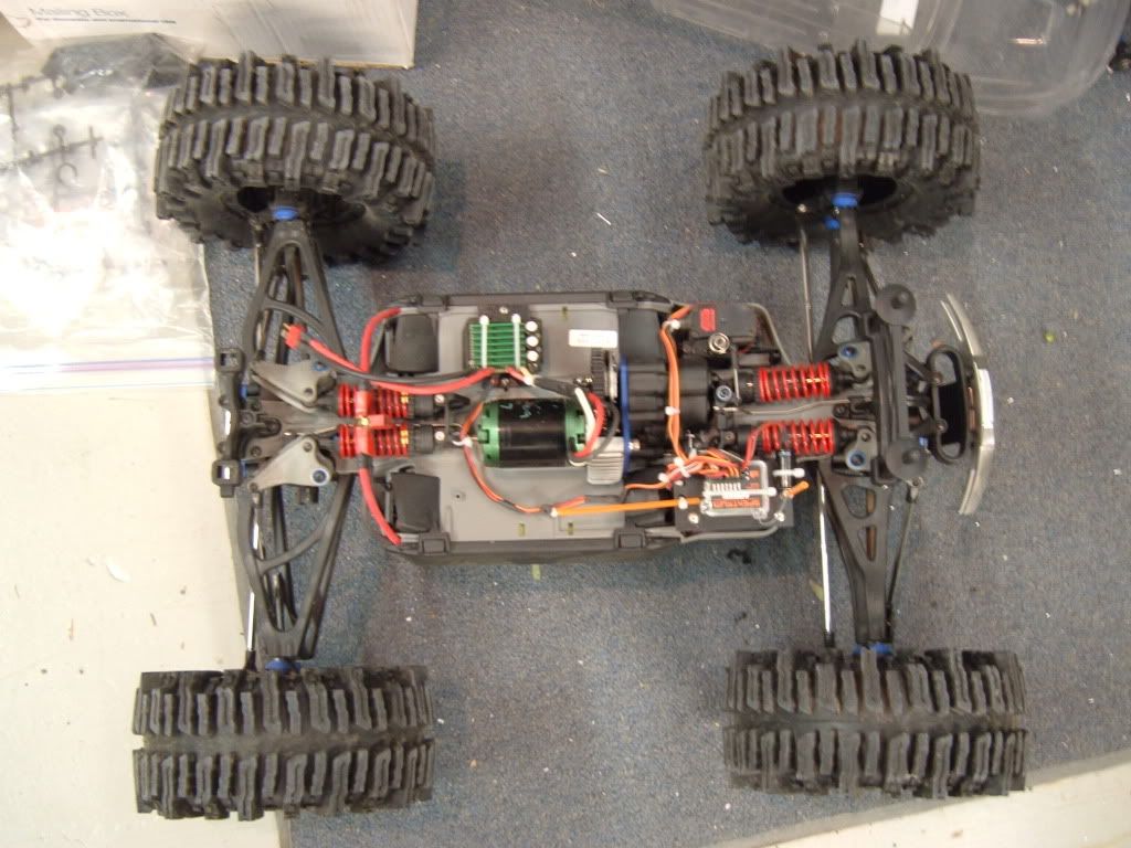

Ok, got it driveable. Will have pics up this afternoon.
Gave it a test run on 3s lipo. Decided that having the steering on the left stick was too much for my limited coordination, so I put it on the right stick with the throttle. Much better. With the 40 series slingers this truck has a ton of traction.
All controls are working as they should, and the 9100t seems to be turning the wheels ok. would like a more powerful servo, might give one of those hv turnigy servos a try, on 3s lipo of course!
I do have 2 4s 3600 12c lipos that I can run in parallel, not the highest discharge capable lipos but this truck does not have a ton of load... We will see, given the performance on 3s I will be gearing it down on 4s, as it is plenty fast in 2nd gear now.
Looks like a proline f650 body will be a good fit, that body fits a 15" wb nicely.

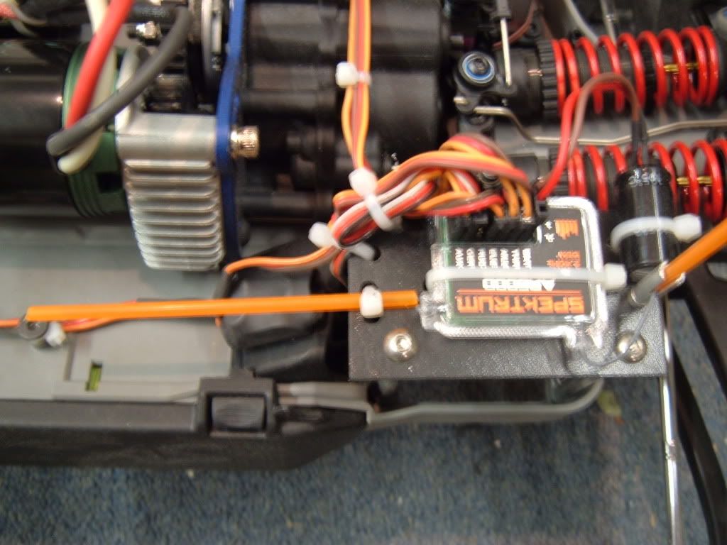

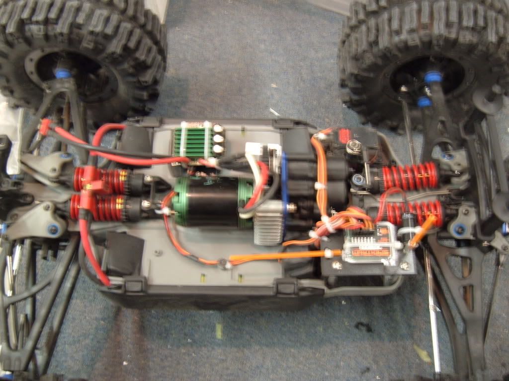

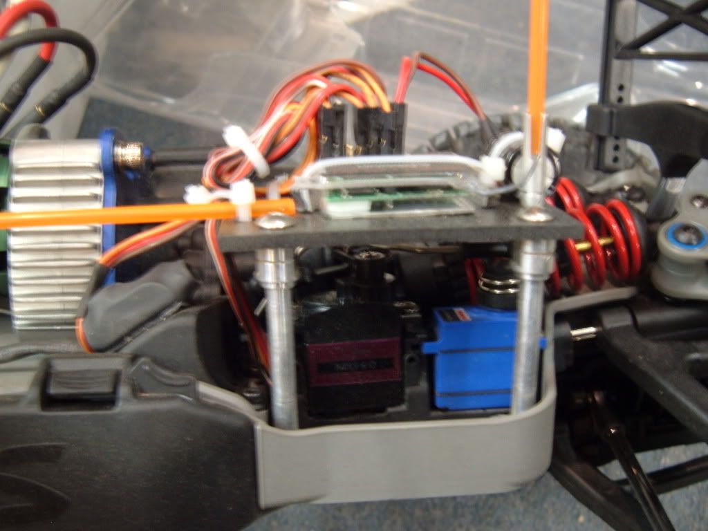

Here are a few pics to how the wiring setup.
Made an elevated tray to hold the receiver. Use a few diff posts from a hyper7, and a scrap piece of kydex. Also found an antenna holder from a tamiya something or other. The bec is double stuck to the battery vent. You can also see my esc signal wire routing, kinda funny but I wanted to make sure it did not get cought in the outrunner rotating can.
I will say this cc outrunner is very torquey. I currently have the startup at low and with 4s lipo it has a very smooth start in both 1st and 2nd gear. My paralleld 12c lipos are ok, but I have a 6500mah 35c hyperion pack on the way for this build. Should shave some weight and give me a bit more discharge capability.
Everything works great, and I manged to snap a welded cvd shaft, I was jumping curbs. Must do around 30mph in 2nd gear. All temps are great, and it will almost wheelie. I have the punch control set at 50% and may well go up to 75%. No real need for tons of acceleration in this beast, especially with me on a stick radio controlling it!!! I am getting better, but it still feels weird to not use a wheel radio.
