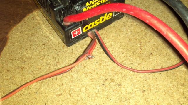

Ok, so wires came loose and this happened. How best to repair it, otherwise need to send it to Castle, which 70 bucks is a bit steep for this.

Cut it, separate the wires, re-attache the wires, shrink wrap or seal with liquid electrical tape, voila, back and business all for the price of about 20 minutes worth of work.

or castle only used to charge $15 for wire repair.

You do but there is nothing wrong with the ESC except for the rx cable. Contact castle they will take care of yiuu

Hi.My MMM esc did the same thing,the wires weedled their way under the spur gear.I just cut the wires,soldered,& shrink tibed 'em.Got reverse I didn't have too:)
