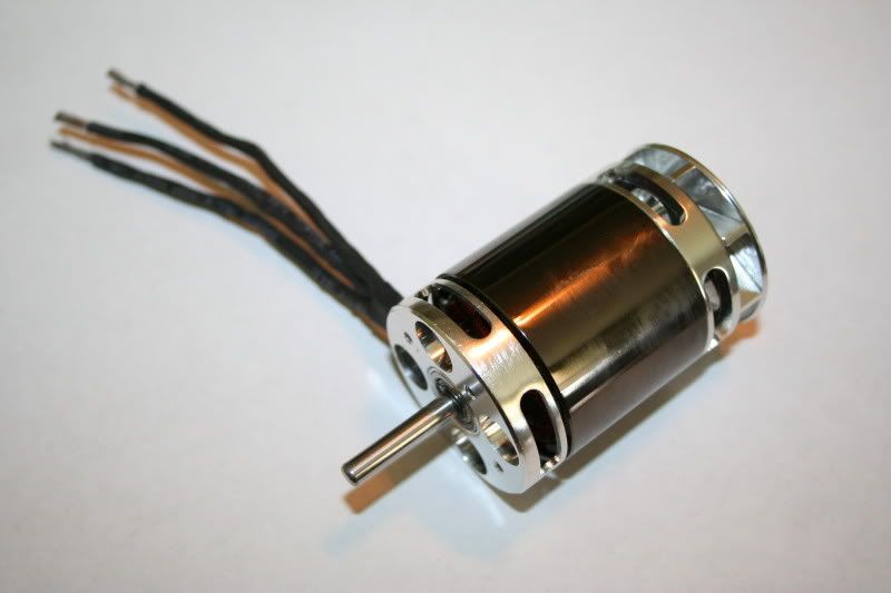

I got a KD 600L 1400kv outrunner for $27 plus overseas shipping from HK. I have always wanted to try an outrunner. I've heard that they have a lot of torque, and are very smooth creeping speeds. I'm about to get into long range FPV (remote live feed) video on my E-Revo, so this would be perfect in my adventures in the woods.
Motor specs:
1500 watts
58mm long (but the actual can is only 35mm)
43mm in diameter
Pics:
First out of the box.....

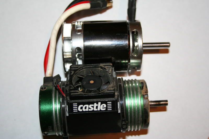

Next to my Castle 1518 monster.......

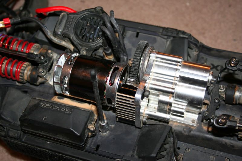

In the E-Revo......

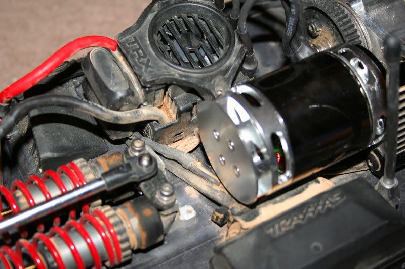

Look how much room I have back there (with the 1518, I only have 2mm of spare room)
Now, I only got to drive it a little last night. So I am pleasantly surprised with this motor. I had it geared for 35mph running in tallish grass (yard needs mowing) and it was 85 degrees out last night (at 10:00!!). Although I was not brutal on the motor, I did push it well. I couldn't get it over 135 degrees. (I do have an aluminum transmission case, so that helps some) Later on today, since the sun will be up, I'll push it for all that it is worth. When I have my Castle 1518 geared for 45mph, I can run it like a maniac on a 100 degree day and not get over 165. I did notice that the motor would cool VERY quickly....even faster than my castle motor with a fan! I was very impressed with how smooth it is.....cogging in near non-existent. Only if I go 1/4 of a mph over the curb with it cog a tennie-winie bit. Despite the fact that the motor is considerably shorter than my castle one, it held its own very well. It has good torque (not as much as my 1518), but it for sure is not a wussie.
