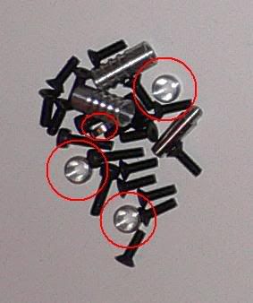

Here is my review of the FLM10700 LCG chassis. I have submitted feed back and constructive criticism to FLM using both the contact form on their web site and their direct email address but I haven't heard back from them.
I have emptied maybe 10 packs and drove the chassis primarily on grass and on two or three occasions on gravel. I did not bash the chassis but did do some small jumps on a track.
Spec's on my truck:
- 4s Lipo
- Hobbywing 150 ESC/2000 kv motor
- Hitec 5996TG servo
- Traxxas #2218 rx
- Weight ~11.5 lbs
- Runs about 55 km/h (35 mph)
Videos of the truck running:
http://www.youtube.com/watch?v=qMMNwkZjmgc
http://www.youtube.com/watch?v=McQeofeKA8Q (in this video I tested a carbon fiber bottom plate I made myself)
I find that:
1. The chassis is well made and designed. Everything fits together nicely. It drives great!
2. It's perhaps a question of taste but I think the bottom plate is a bit too "simple". I'd love if FLM offered an optional carbon fiber bottom plate or if they'd bent the aluminum bottom plate to strengthen it much like was seen with the GorillaMaxx chassis. I would like to mention though, that I had no issues with using the FLM aluminum bottom plate.
3. The top plate is too thin. This causes the top plate to flex from the power of the servo.
4. The cut out in the chassis around the spur gear is critical! As you can see in the picture below the chassis snapped/broke during my last run and I did not make any huge jumps or bash it hard in any way.

UPDATE: I received a mail from FLM today and this is the first break they have seen like mine so I could have had some bad luck with my chassis. They mentioned they would revise the design and send me a new top plate if I paid for shipping. Pretty cool, FLM! Thanks. :)
