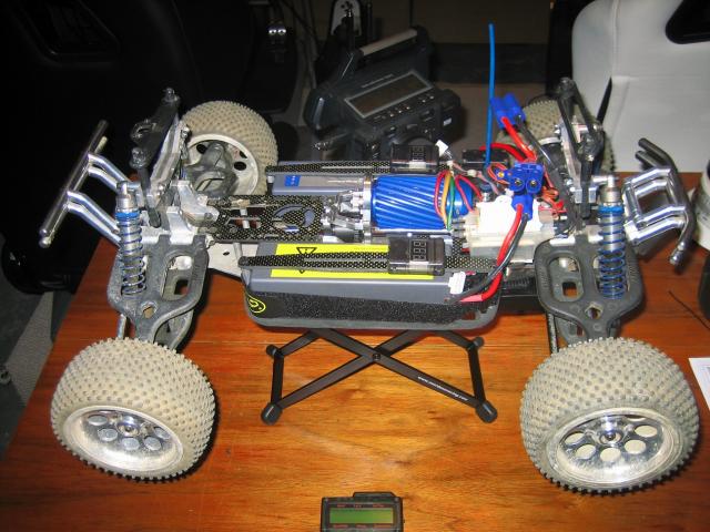

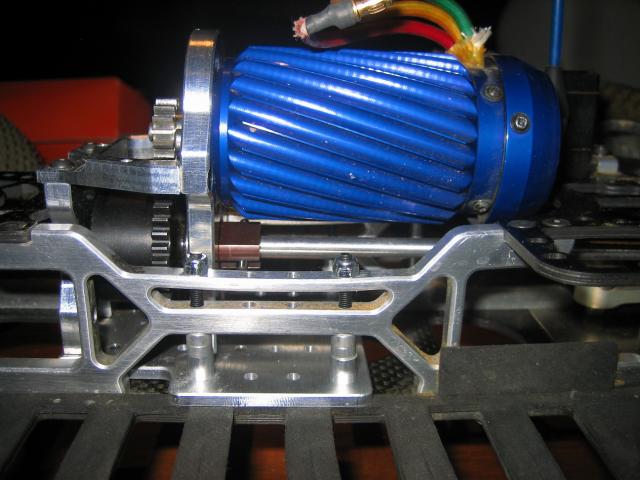

After six years I decided to start tinkering with my old CF G2 Gorilla Maxx chassis.
I really never liked how the Plettenberg Bigmaxximum sat hi and off center so I decided to go the Center Diff way after much reading on this forum and bugging the hell out of Mike
In the end after having spent hours designing a weak mount, Mike convinced me that his universal mount was the best (easiest and most effective) way to go.
Here is the (almost) final product geared way too high but hey, if ain't broke...break it.
ID:	10543   Click image for larger version
ID:	10544   Click image for larger version

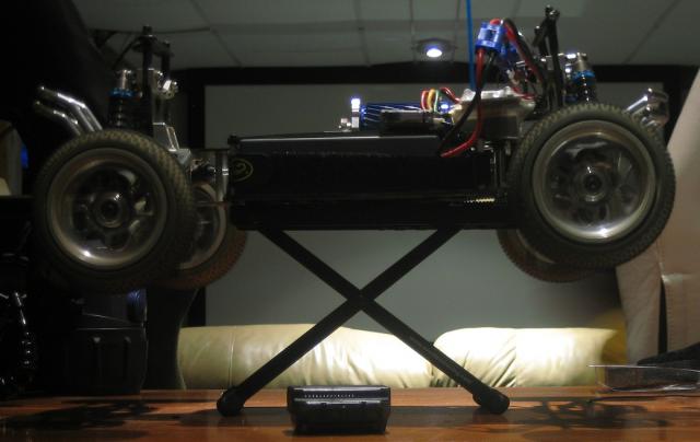

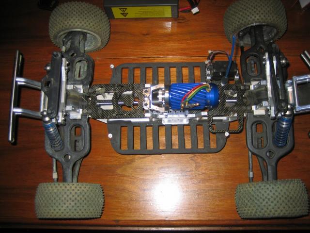

Here are some more pics of the (almost) final product...
PS. The gearing is WAY too high, I barely hit 8,000 RMP and look at the ballooning.
ID:	10546   Click image for larger version
ID:	10547   Click image for larger version
