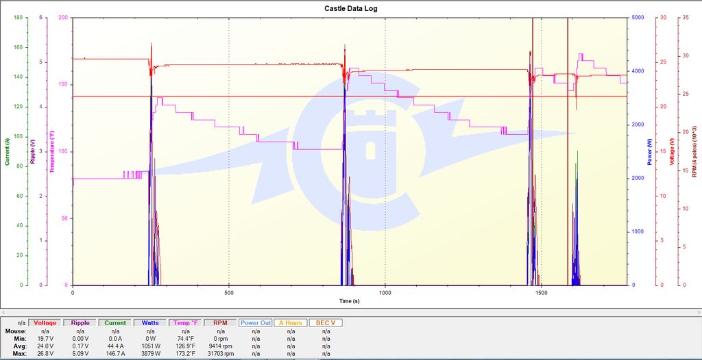

Here's a log of 0verkill's 1/8 Truggy geared for 153 mph no-load with a CC1515 and MMX. Log indicates some bad-ass ripple and Voltage dipping to 3.28V Cell, and based on low RPM and relatively (considering the gearing) low peak Current, it seems ESC is holding back, no?

Yes, the ripple voltage was bad on that over geared run. Phil, what's your ripple voltage on your passes?

04.12.2016, 05:59 PM
