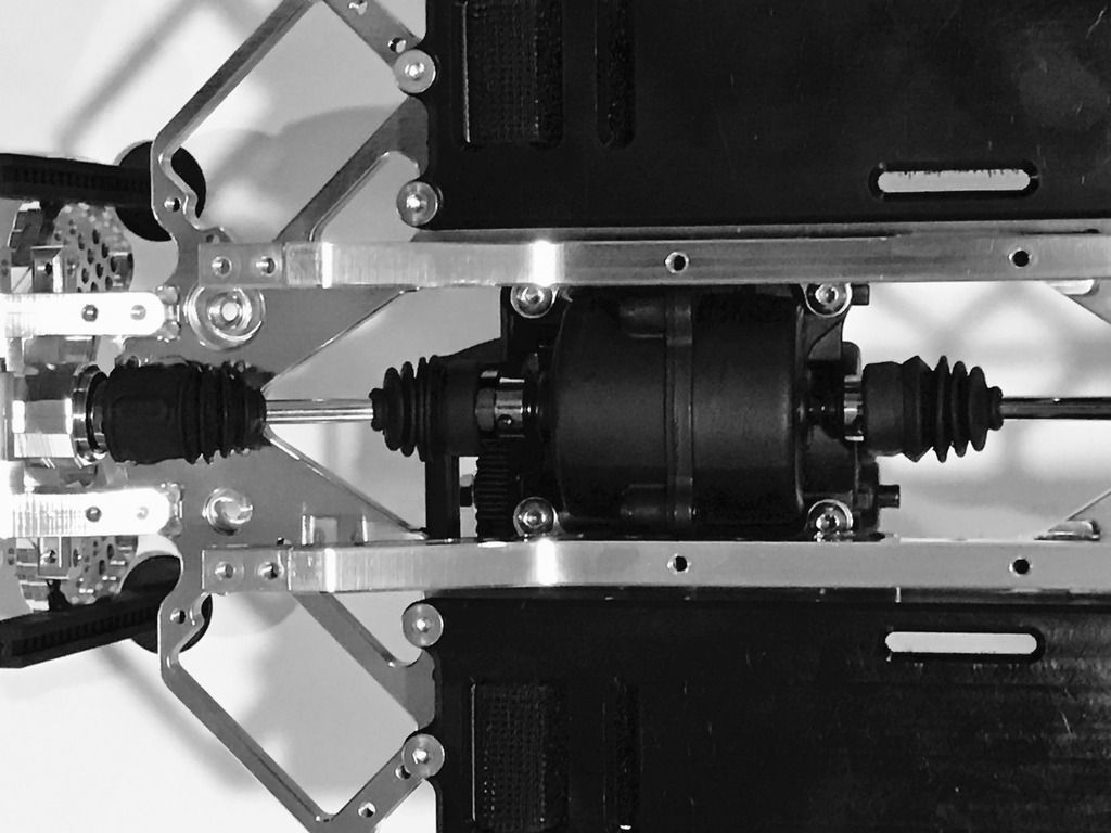

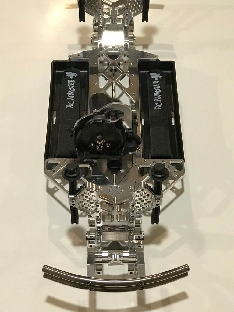

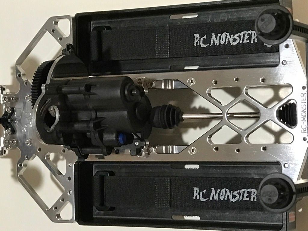

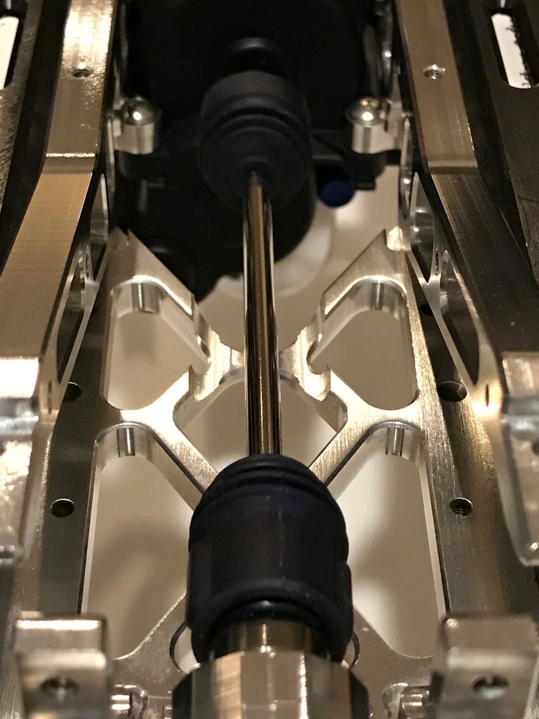

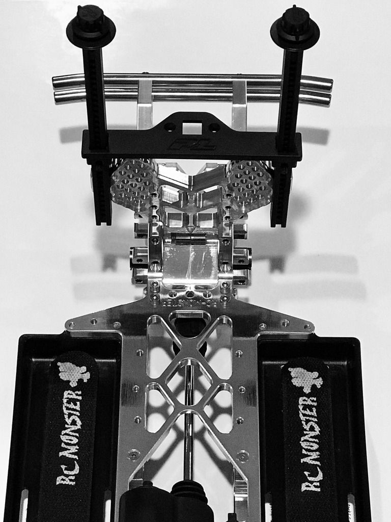

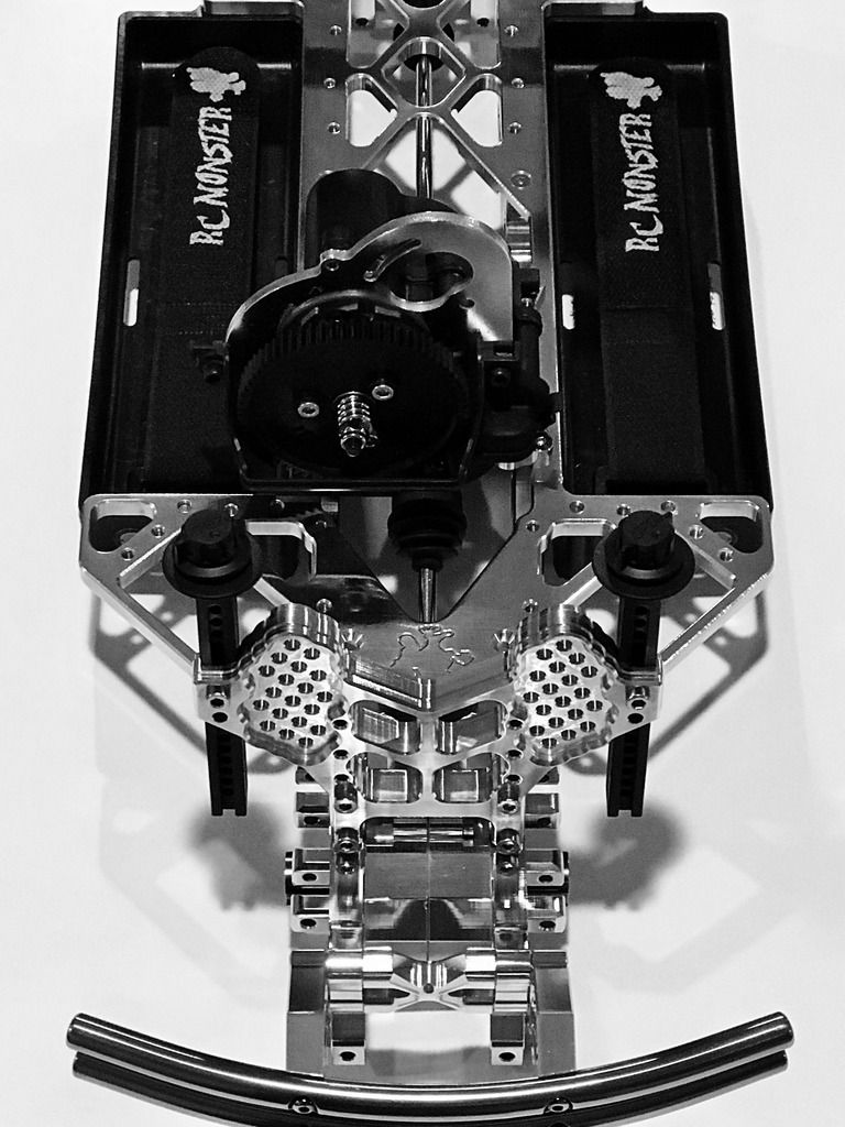

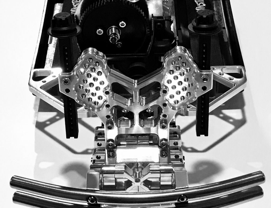

Here are some recent pictures of the updates to the V-MAXX build and more to come. i will be using another body for the build; however, another 73 Bronco and different color. I just recently ordered a Gen-3 Robinson Racing slipper clutch to replace the stock slipper clutch.

  (#57)
01.02.2017, 11:07 PM
Nice build.

  (#59)
01.03.2017, 10:11 PM
That's coming together quite nicely. I love the Hi-Res pics. I can't wait to see what else you've got planned for it.

Maxxamongus
Maxxamongus's Avatar
Posts: 120
Join Date: Aug 2016
Location: NorCal
01.03.2017, 10:22 PM
Thanks _Paralyzed_! I just installed a Robinson Racing Gen 3 slipper clutch to replace the stock one. I am working on all the mechanical parts for now. Later on in the build the electrical components will come into play cause' I enjoy the research end of the build. Look forward to posting the results of the build.
