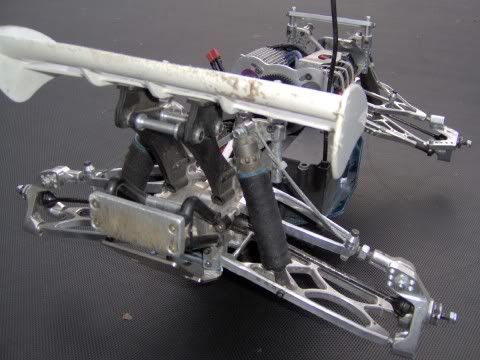

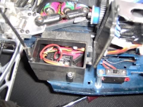

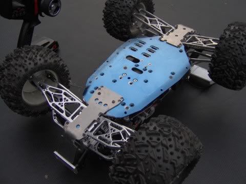

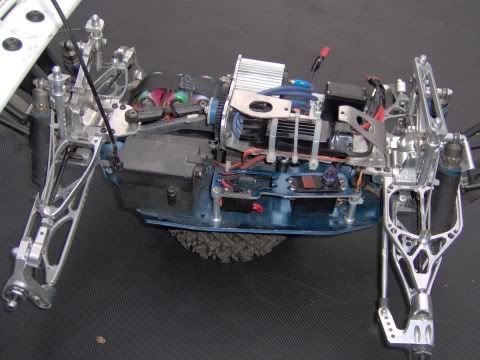

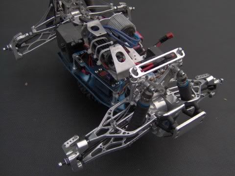

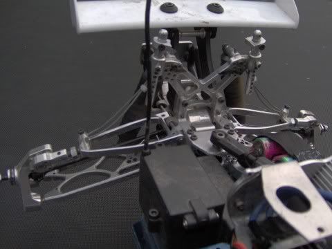

Here is a few pics of my emaxx...that I used a Ofna dominator chassis as the main platform..

what motor are you running

Very nice. How does it handle?

Im running a 1920/8 Lehner motor with a 2095 micro controller

squee, it runs great...very stable....but I'm still able to lift the front end off the ground with ease.....it was well worth the work...which took me about a week to do

Nice one! i can see you spent a lot of time in it.
One point of concern ( but i am sure you thought of it yourself too) how is the balance with the 12 cells on 1 side?
Nice aluminum add-on on the racer-X rear upper arm!

1920 on 12 cells, sounds intresting, those motors look tiny.

the 1920/8 on 12 cells is pushing 3919 RPM per Volt...so @ 14.4.....Im runnin the motor in a rpm range of 56400.....and if i go up in more cells ... it just gets faster...I've actually have ran this motor since 2002.....which was back when hacker had there controllers and such......the motor has actually outlasted my 1895 micro that I fried last year.....I'm very pleased with it and the setup......also thanks neweuser for all the help...and everyone else for their comment.....

It does'nt run hot at all??

squee....it runs hot....but not to hot....i can put my hand on the motor and keep it there for several seconds if i want.......I've really never had a overheating issue with the motor or controller....although I do have to say the motor is a little spendy.....but it has lasted several years....and hopefully several more

Very interesting. It looks pretty cool. I was concerned about the balance issue to having all the cells on one side. I am glad you like it. You wouldn't happen to have a video on it would you?

Im not sure on how to do a video ....i think our camera can do them...I'll check..and see what i can come up with....as for the weight issue...I really don't notice it at all...it still drives pretty even and balanced
