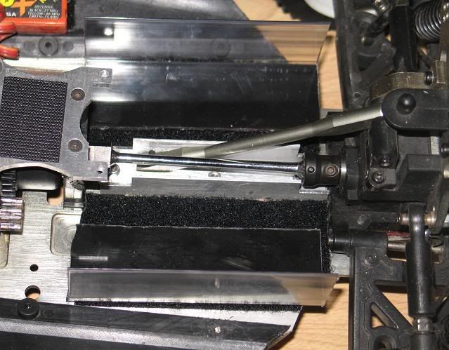

I suppose I could try out new mudguards, but finding them wouldn't work too well. The LHS I work at (only close one) only stocks one 1/8 buggy: the XTM XT2. While I could try out the mud guards from that, I just don't think it would be worth it. With the Maxamps batteries I plan on getting, they will easily sit neatly on the chassis, and what's good about that is that they will remain closer to the centerline (as close to it as they possibly could). Here's a pic to show why I can't mount batteries on the stock mud guards:
You'll notice that there's a ridge where it meets the chassis. That ridge is actually raised above the outer surface of the guards. I can't just shave the ridge off since the ridge is only there because of the angled edges of the chassis.

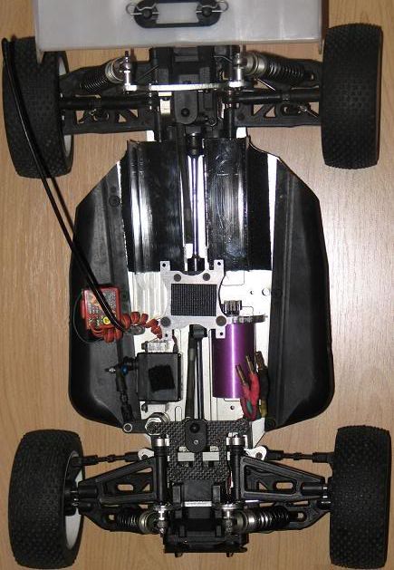

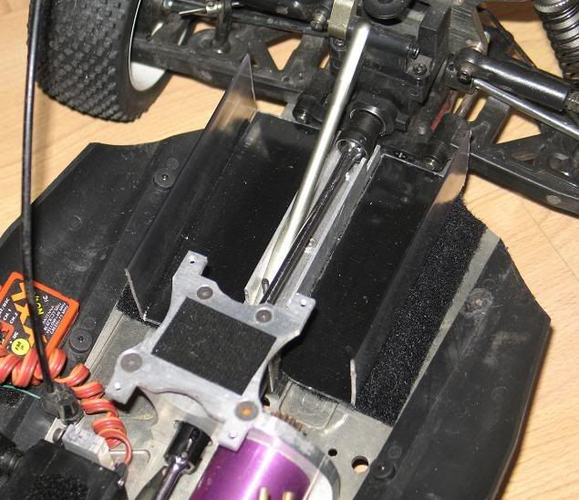

A few days ago I finished the battery holders, but still have to do the battery straps. Soon (very possibly this weekend) I'll be getting some batteries from Maxamps. Originally it was going to be a 4s2p setup using the 2100HV cells, but glassdoctor convinced me to go with 4s3p for increased capacity and increased amp-handling capability. This pack will also end up being more economical for me since the reduced current draw per cell should allow the pack to give more cycles.
Here are some pics of the battery holders:
This setup allows for a battery up to about 35mm wide to fit.
It can fit batteries up to about 50mm (2in.) wide. Unfortunately the length is limited to about 105mm.
