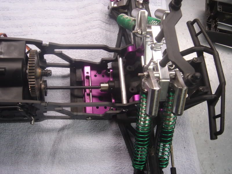

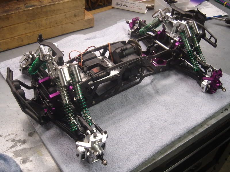

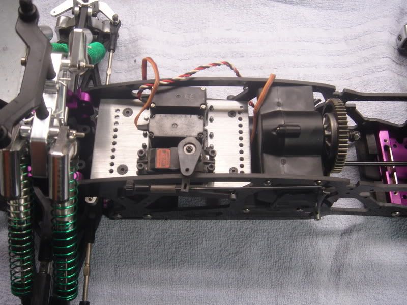

OK guys here she is.
I put her on a diet and dropped a wopping 4.5 lbs off her.
She now sits at 7 lbs in the pic. I will be running 40 series Dish 23MM with Crimefighters. That ads another 2 lbs.
To keep the lower CG I have softened the springs so I have more droop. I will adjust once running it.
Any thoughts.
Bought my Wife a Rock Garden :027:
cemetery gates
01.25.2007, 11:00 PM
Looks really good! You should have one sweet truck when its brushless. If someone hasn't already said it, you really should run a plastic spur. The pinions get all chewed up on a metal spur due to the massive torque they produce...
