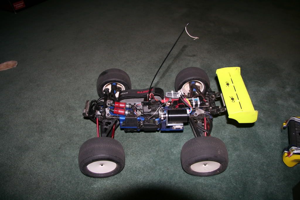

WWHHUUUOOOO, look at THAT center balance! I could be mistaken, but i think i even see the shock pre-load increased on the battey side! :005: Isn't that 1200 grams on one side?!?
The lipo is about 625g + the esc, on the other side there will be the motor and motor mount, plus 2 servos. It is a little off but nothing to worry about...

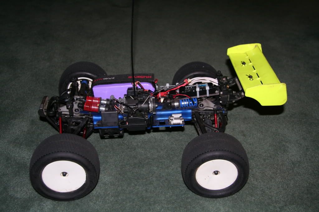

What is that black thing holding in your battry? Do you have a link? I am trying to find a way to hold in my battery. Also how is it working out for you?

the strap he is using can be bought at home depot. I belief he is using the medium one. just go to homedepot.com and search for husky strap.

First off, the husky hangalls strap did come with a hook and extra material to attach it, I just carefully cut the uneeded material off.

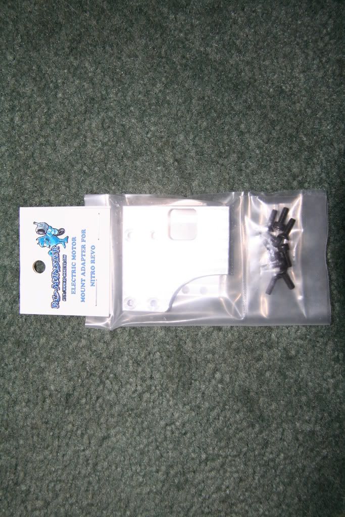

Ok, I got the mount today!:017: Mike even included the nice tag on the package too!
ATTENTION!!!!!!!!!!!!!!!!!
MIKE'S MOTOR MOUNT WILL NOT FIT NEU FINNED CAN MOTORS WITH OUT MODIFYING IT!!!!!!!!!!!!!!!!!!!!

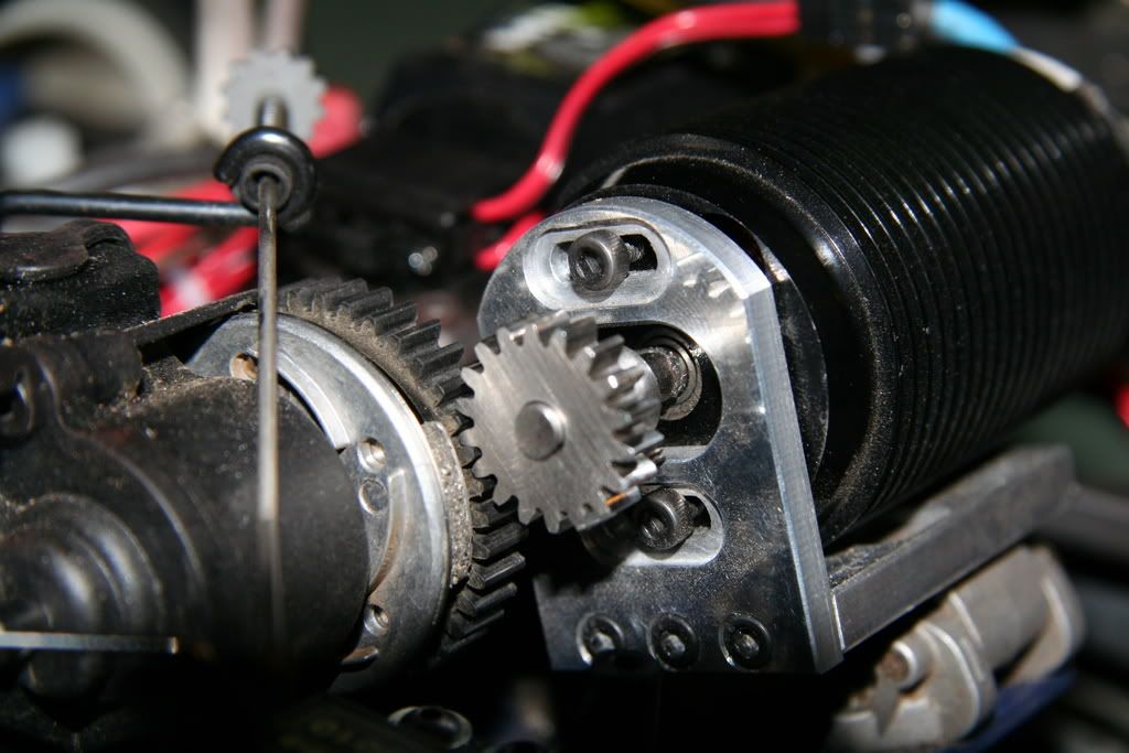

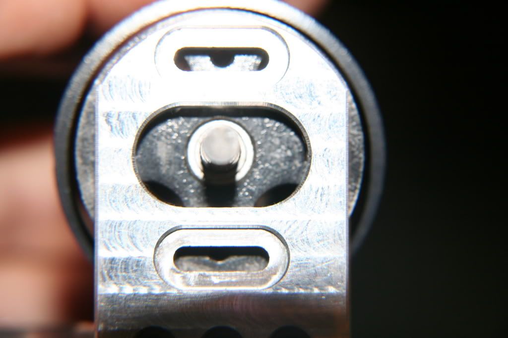

Just thought I'd let everyone know, heres why:
Because of the fins on the motor, it is to wide to line up with the mounting holes; nothing a dremel cant fix. Also the rear support doesn't really fit either, though the motor rests on the bottom of the mount so you don't really need it anyway...
Fixed it with a little help from Mr. Dremel...
It's complete!:
I ran it today, auto shifting with an electric is cool!; there is no lag at all like with a nitro, no drop in rpm's. Also what CD oil should I run? I have 120,000 ofna stuff in there now, and it just unloads the front tires like crazy and acceleration suffers because of it...

looks great, that mount is cool, what size spur are you running with that 18 tooth pinion?
  (#30)
cemetery gates
04.06.2007, 10:26 PM
Originally Posted by GorillaMaxx360
very nice
Thanks!
Thanks! I am running a 38 tooth spur, going to get a 36 tooth spur tomorrow though. The temps are great on this setup, 20min+ driving and every thing is cool, not even warm.:028:
