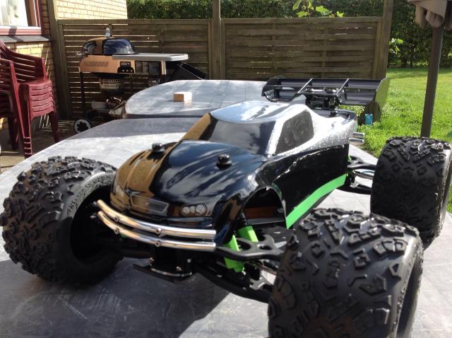

Loving the orange chassis Mike
So finallly got her running all set for a trip to Copenhagen on Thursday ready for some proper track time
Bang on the money with Revo bodies Mike ..this is the discontinued JConcepts Illuzion body..had to ship it in from Spain but well worth it in my humble opinion

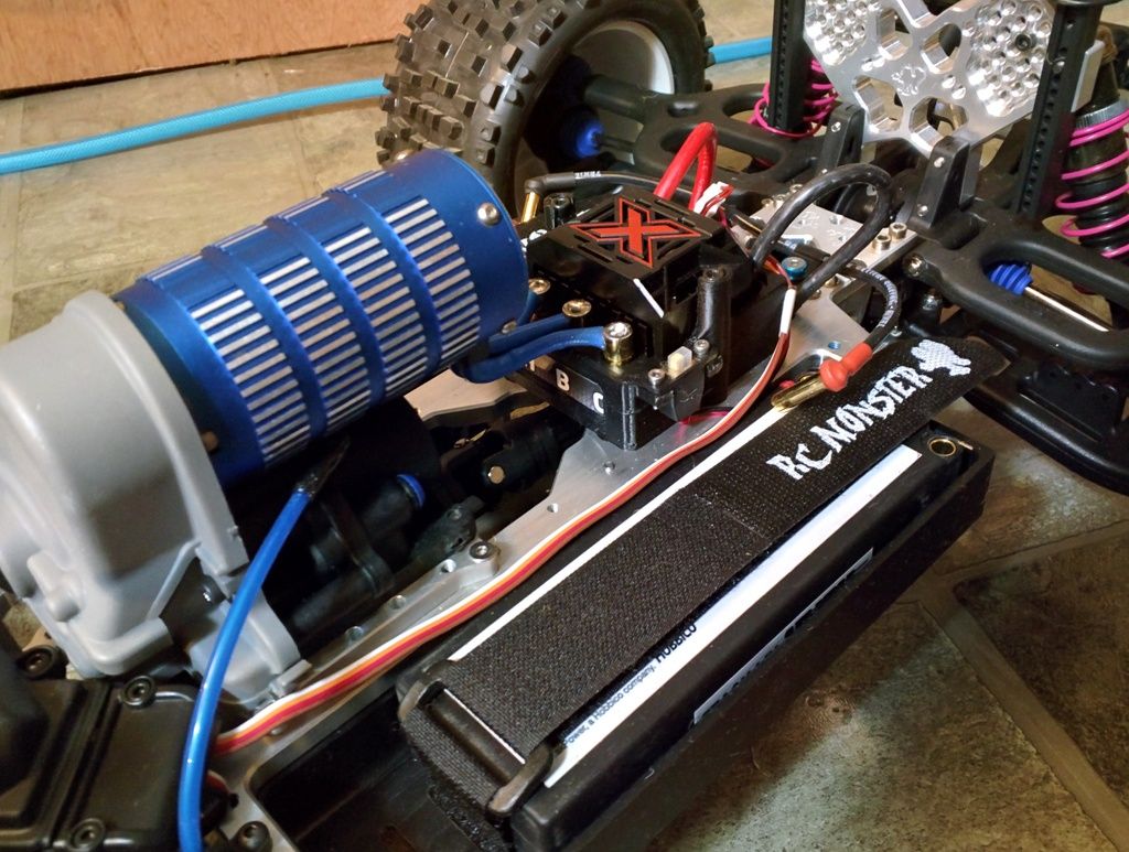

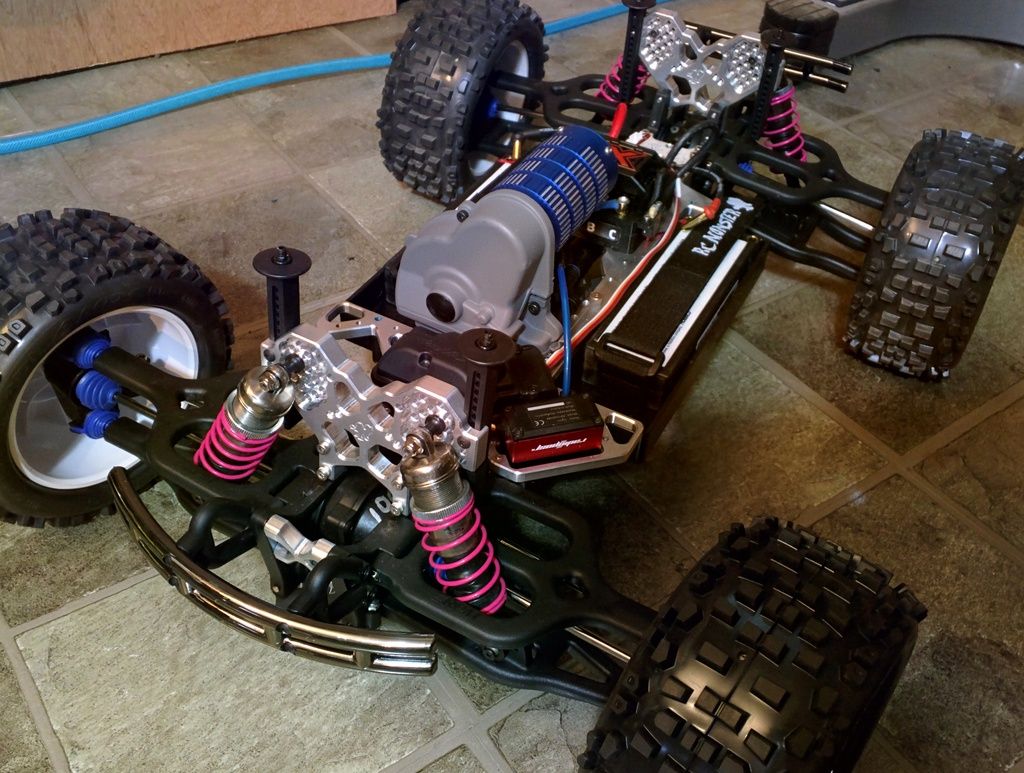

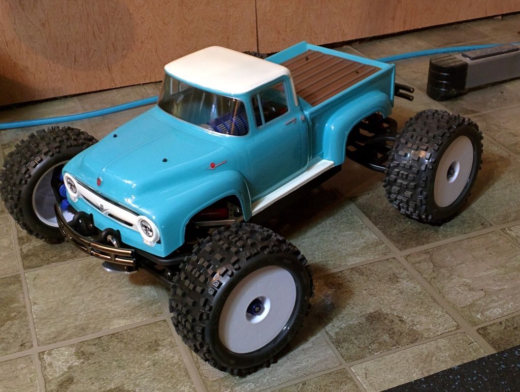

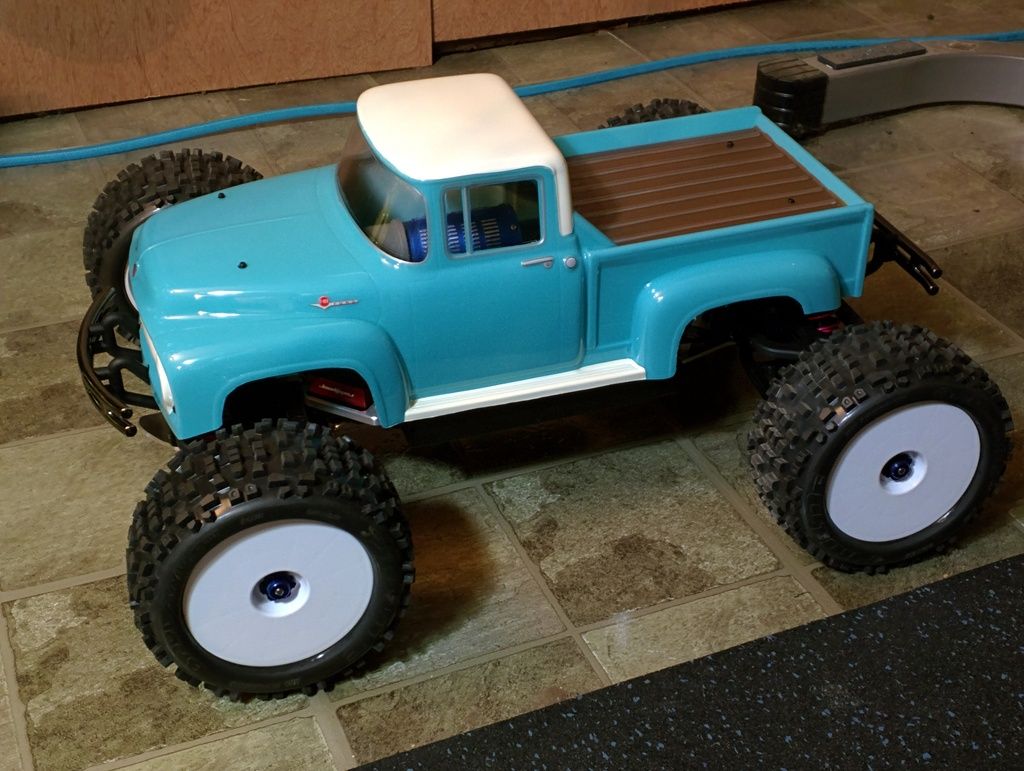

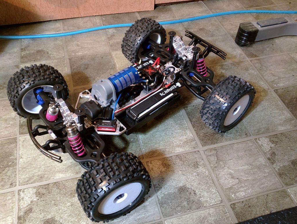

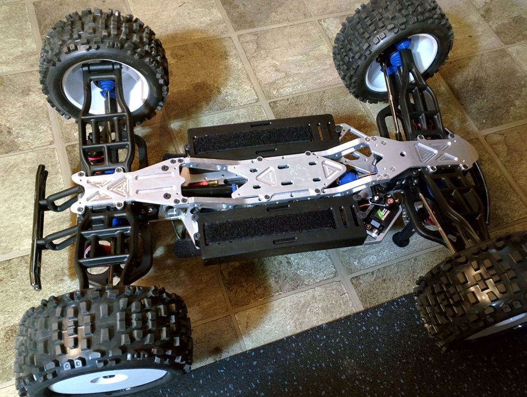

Since everyone else is posting pictures of their builds... Here's mine. I am planning to switch to the center slipperential and universal motor mount and the hybrid diffs, but I didn't feel like figuring out the center drive shaft situation and I really wanted to get this running so I could do some bashing with my nephew. So I went this route for now. I'll upgrade it later.
As it sits now :
  • RCM V-Maxx Chassis (of course)
  • RCM 35mm V-Stretch
  • RCM towers
  • RCM skids
  • Traxxas cvds
  • Rpm bulks
  • Rpm arms and true track
  • Mamba monster X (custom mount I designed and 3D printed)
  • Hobbywing 2000kv 4274 motor.
  • 2s TrakPower 5600 90C (x2 for 4s)
  • Stock transmission Geared 26/62
  • Stock diffs
  • Radio post red servo (running on 8v)
  • Kyosho MP9 front shocks all all round (1 per corner)
  • Badlands on zero offset wheels
  • Proline 56' F100 body
As soon as the paint dries and I can get the body shoe gooed up inside for durability it'll get its maiden beating. Lol.
And now,... since nobody really cares unless there are pictures, here they are.

Bravo man! That's a good looking truck!

Looking great, Jeff - I like the custom ESC holder and short motor wires...super clean. Here is a quick tip: the rx lead from the ESC can be tucked in between the battery tray and chassis brace - safe and outta site. :-)
