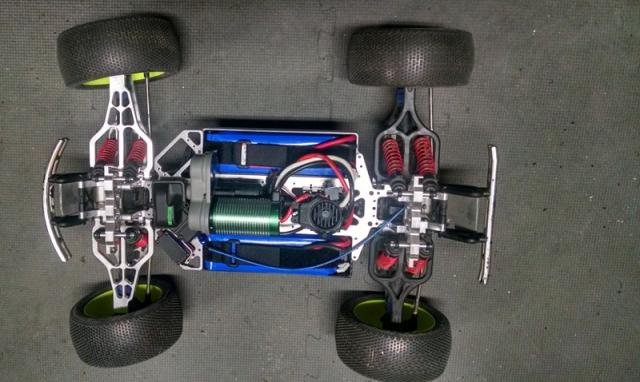

quick pics - not done yet, but getting close - 03.01.2015, 10:44 PM
Just a couple mock assembly pictures - still have spacers, bushings, type stuff to make, along with tweaks and enhancements, but you can get an idea what it will look like. The prototype is .19" thick, but final may change. I do like this thickness, as it balances durability and weight rather nicely.

03.02.2015, 08:28 AM
Underneath pic? This just may spark me into another Emaxx.

03.02.2015, 10:29 PM
I will post pics from all angles once I have everything finalized. :-)
