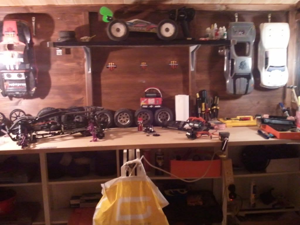

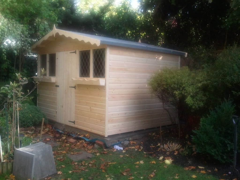

[align=center]As it is winter here... i can no longer wrench outside as it is just tooooo cold... So i have been making a new workspace in my garden...
How i set it up on the inside
[/align]

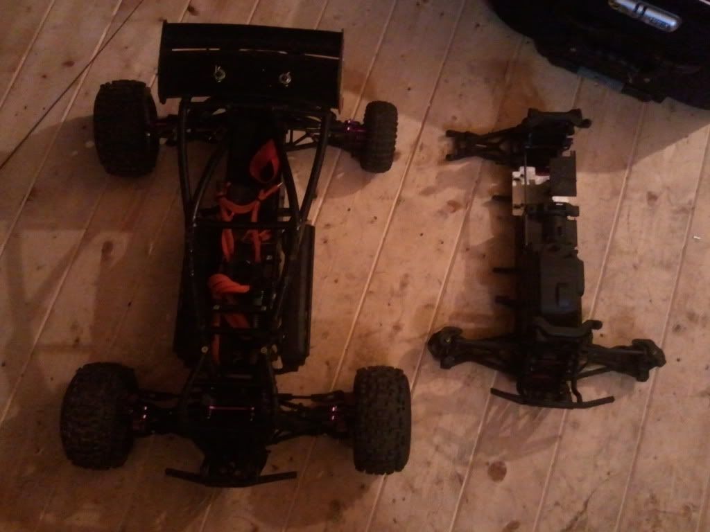

So at the moment... i am still trying to see what i want to do, and get everything built correctly for the XXL Savage...
As the new MMMHV (12s version) is not available yet and i have a feeling it wont be available for the next couple months due to the 8s version being released first... I have decided to tear the truck down COMPLETELY AGAIN and get all the alloy bits re anodised in Orange or Gold (most prob orange)
Also the reason for this rebuild is because i am building a second savage...
I am starting to miss the Standing Back flips, quadrouple back flips of jumps *and the crazy hecticness that a stock length savage flux is known for....
So i have starting piecing a savage together out of all my spare bits, and fell a little short. This is why i am going to take bits off the XXL savage and purchase all new bits for the XXL so it is shiny and sparkly once again and ready for 9s power!!!!!!
Plus it is NO LONGER POSSIBLE to jump the XXL... It is just a little too heavy, and too long, resulting in annoying arm breakages etc... So it will just be a handling, speed machine and the stock flux will be my hardcore basher....
[align=center]So this is where i am at currently....
[/align]
I will be keeping this as stock as possible, but will be doing the usual BP upggrades...
I was going to buy some more BP Diffs but i will just take them from the XXL Savage and use HD Diffs in the GH Bulks as frddy from HPISF has been using his old stock HD Diffs in the GH Bulks with Much success as there is no flex... If they fail, i will just change them eventually... But this is one way to save some money in the mean time.
Need some integy rear hubs and i may stick with plastic front hubs on the basher for now... But ill see...
