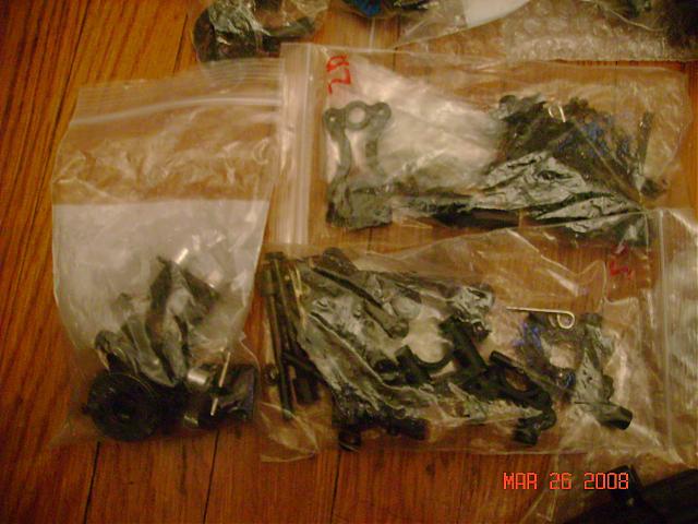

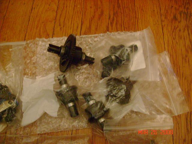

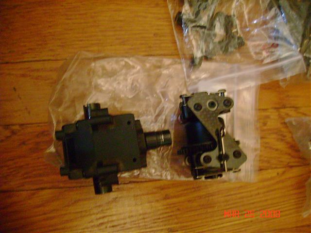

Here is what I had in mind. AWD braking. I've seen 1/5 and 1/4 scale use this, but mainly in the front wheel and a few do have them in all 4 and my idea will be inboard instead of them being at the wheel. I bought all the parts, but when came time to actually doing it, I was stuck with no time and skills to put it to work. It's easy and if I had the time I could actually do it. I even thought about going 4 discs in the front (Like a dual disc set up for each side) and 2 in the rear. I thought of using a similar set up like found in 1/5 scale, but also do something to utilize linkages to engage the brakes. I have attached a few pictures of the parts and the idea next to a diff case.

One more picture and the idea is out in the open. If someone can actually do this, I'll be happy if you can send me a system as well to put in a HV 1/8 buggy. Keep in mind this idea can be put in basically any scale.
