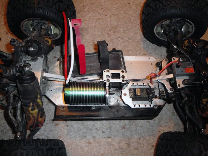

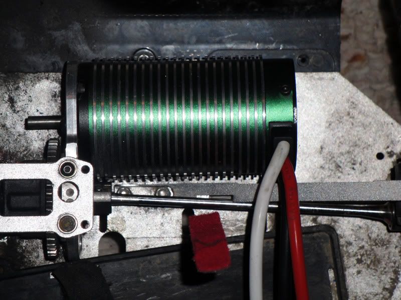

12.18.2009, 11:22 PM
Posts: 368
Location: The Town, CA
12.19.2009, 12:09 AM
Originally Posted by Unsullied_Spy
As far as mounting, I bought a Tungsten Carbide cutter for my Dremel (Part number 9903) and it made mince-meat of my RC-M motor mount. I widened the channels to accept the 4mm screws in about 30 seconds then spent a minute or two smoothing it out and it came out great.
Mounting in a Muggy is a piece of cake and there is plenty of room for gearing. There's still space between the motor and chassis and I can push the motor all the way into the chassis brace and have the rotor so close you could probably put a 9T pinion (or maybe smaller) on it and not have an issue. Can't speak for other 1/8th scales but with a quick bit of Dremelling on the mount it mounts up very well. I'm glad they put 4mm mounting screws on this motor, it's heavy enough that the extra strength may come in handy.
Glad to hear it was a success  And looks great !
