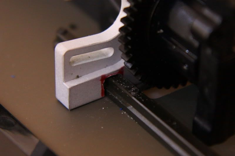

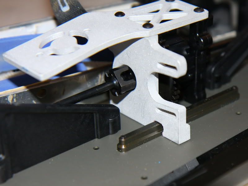

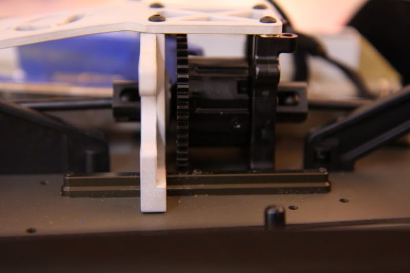

well, i was on the verge of installing my nitro motor so that i can take her out this coming weekend. With 2 emails last week, my plan is back on track. Finally got off my lazy bottom & put the notch into Dan's mount. So, I managed to mount the center diff with Dan's mount. However, I think I may have hit another problem. I am concerned that that silly brace may interfere with the finned motor like the Neu. I tried a finned feigao & it seemed ok but the fg has a smaller diameter. I will know once the Neu turns up together with MMM.

08.26.2008, 02:33 AM
sorry for the poor white balance

ffactory666
08.26.2008, 03:13 AM
About time you joined the club ,very nice , i like Dans top mount .
My Medusa 1600kv is 36mm and just clears the brace with 14t-15t pinion . Not sure on the Neu finned size and will depend on the pinion as well .
What size pinion are you going with ? The larger the further away from the brace the motor will be but then you will have to be running a low kv motor .
