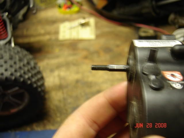

the threads on the input shaft will be cut off

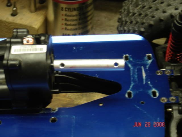

this is my connector for motor to tranny dual set screws will hold it on to the flat spots on the imput shaft and two flat spots on the motor for set screws.

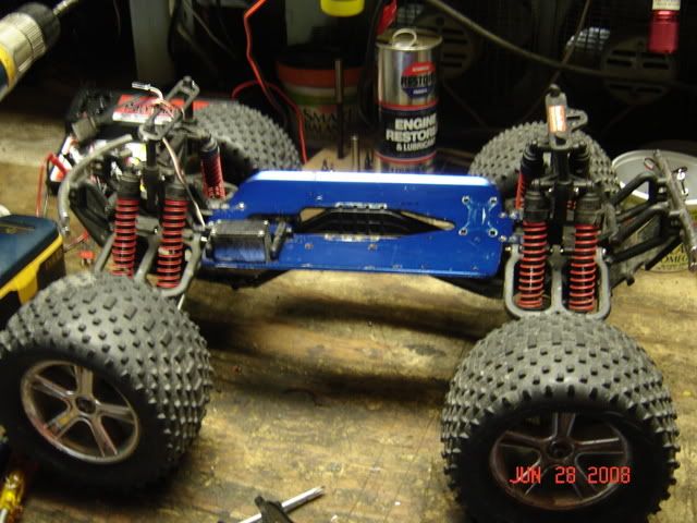

heres the bare frame

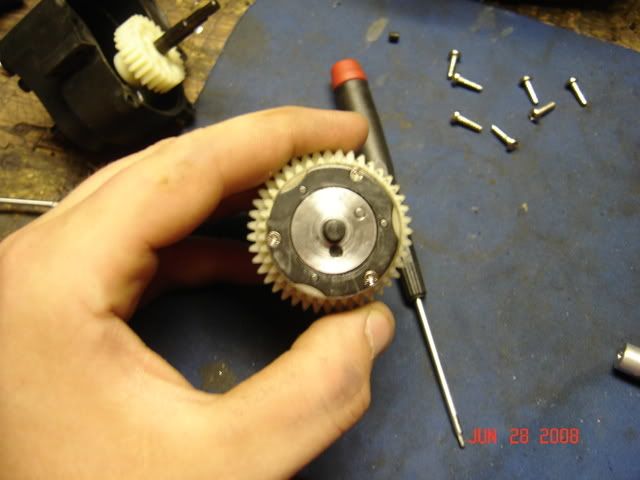

and heres the 2 speed that im going to lock inplace with jb weld.
