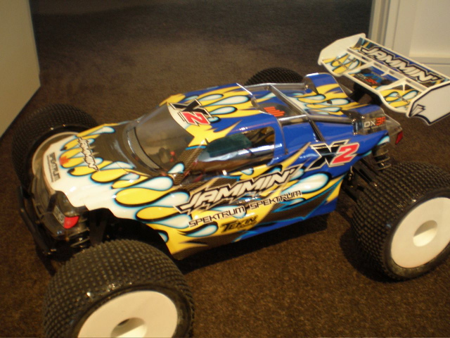

Been a while guys so thought i would post a little update , i'll be quick .
Body was done in UpgradeRC custom skins , and i am now running Lucianos 6s esc ( it's running great and if it continues to do so i will be selling my new MMM v2 ) .
I will now be using the X2 as my basher so i might go from a 15t pinion up to 17t or probably 18t as the esc ,motor and battery are staying cool , all between 95 o - 110 o .
Have been using the Zippy 5s 4000mah packs and am very happy and getting 18mins before the lvc on the esc kicks in .
I made a plate for the esc which attaches to the center diff top plate using the existing top plate mounting holes , the esc is then attached with velcro and some zip ties .
That's it for now , oh some pics as well .

  (#29)
DRIFT_BUGGY
DRIFT_BUGGY's Avatar
Posts: 2,077
10.07.2008, 05:54 PM
That is one sweet as body. Top Job
  (#30)
lutach
lutach's Avatar
Posts: 5,139
10.07.2008, 07:38 PM
Looks good. I hope those capacitors are secured with some kind of tape to keep them from bouncing too much and breaking off.
