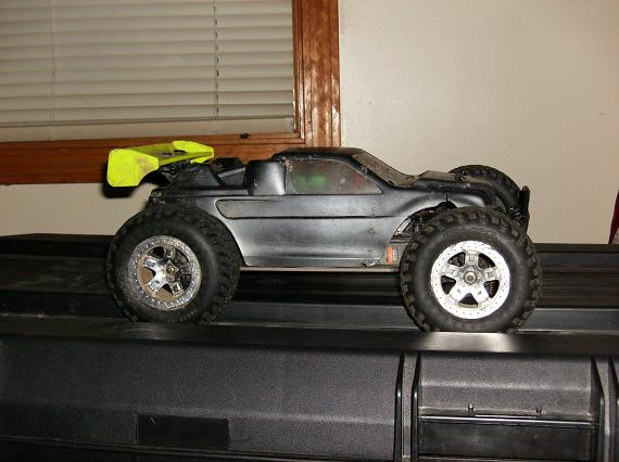

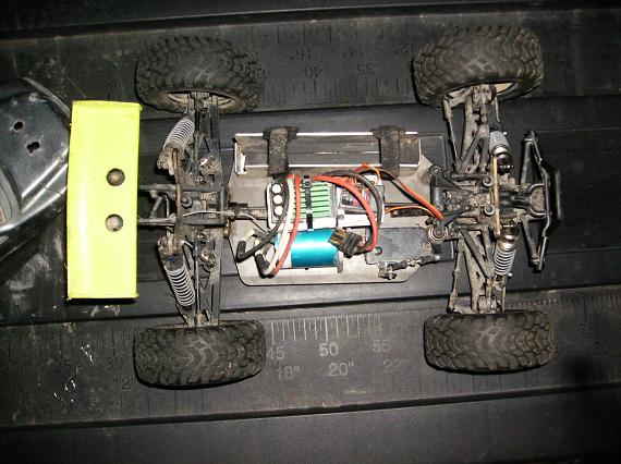

It's a little dirty and I need to paint the new body for it but here is my crt.5 with slash tires on it. MM, Medusa 36-50-4800, Spektrum sr3100 rx, Spektrum 570z servo, 46/15 gearing w/ slash tires 46/19 with 2.2 anacondas or bowties, MaxAmps 6000mah 2s Lipo

R00ST
Posts: 284
Join Date: Jun 2005
08.29.2008, 12:04 AM
Thanks for the pics, it looks pretty beefy with those tires on it! I bet these things tear up the pavement with anacondas on it.

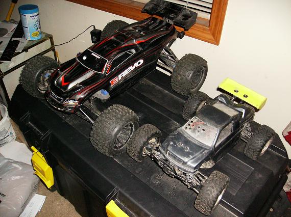

Here you go, keep in mind that although the E-REVO is classified as a 1/10th scale MT but is about the same size of 1/8th scale

R00ST
Posts: 284
Join Date: Jun 2005
08.29.2008, 12:40 AM
Thanks, that really helps! I am familiar with the E-revo... I have built two of them over time. (one with novak 6.5 the other with 9920/9xl on 16 cells...was a fun truck!)
