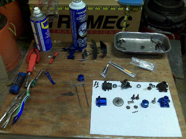

Well I thought I'd revive this cause I just tore out my front diff, cleaned out all the grease, washed, dryed, filled with silicone, and reinstalled it. It took me exactly 10 minutes to get the diff out, apart, and soaking. I spent 35 minutes cleaning and re-assembling, which is gonna happen no matter what diff your talking about. It then took me about 15 minutes to get it all back together, funny that it's harder to get back together, getting the center shaft lined back up is a PITA for the front cause it's so damn small.
