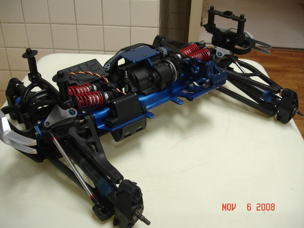

Here's some pictures of the build progress.

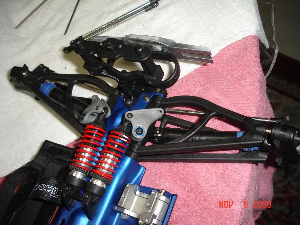

Rear extended arms installed:
Suspension installed:

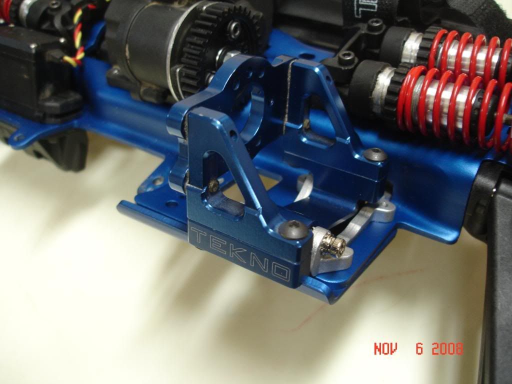

TeknoRC motor mount installed:

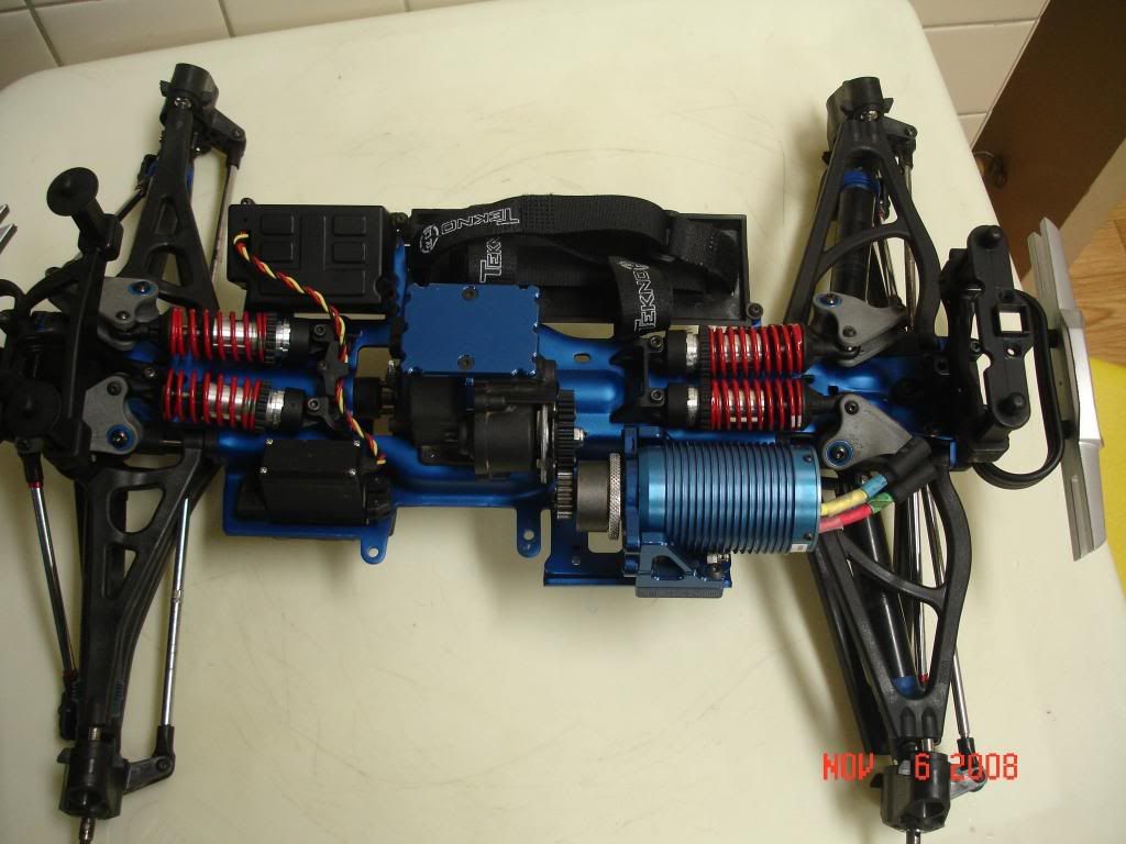

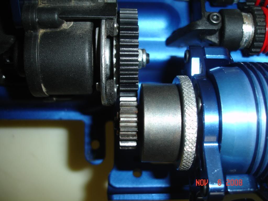

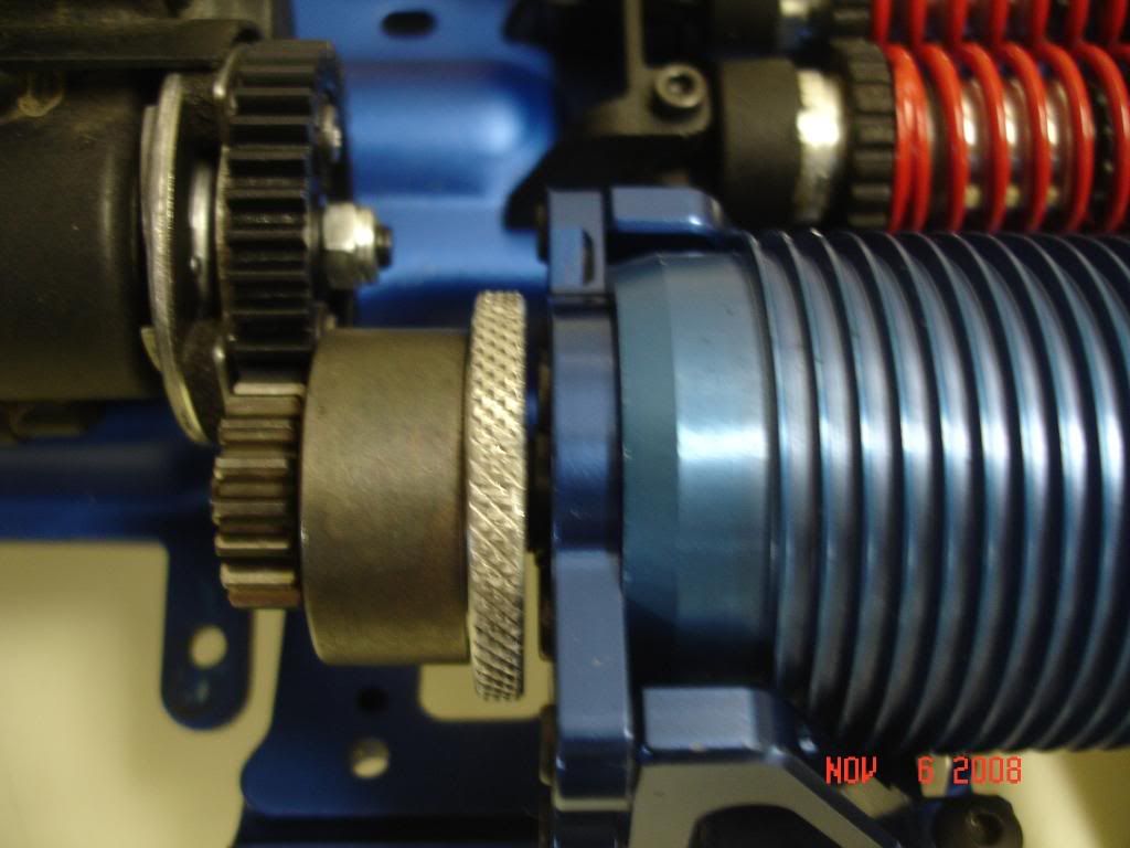

1515 1Y/F installed along with the UE 4-shoe clutch and Kyosho 17T narrow clutch bell. The finned version was almost a tight fit. I had to push it in a little bit. I used 4 8mm caphead screws to mount the motor.
I'll be installing the MMM tomorrow night after I finish soldering all the connections. My target is to do the test run this coming weekend.

I almost forgot I still need the 2S packs I ordered so I can run 4 and 5S on this truck. Right now, I start with a 36T spur and 17T pinion and go from there. If I don't like the temps, I'll go down to 16 or 15T clutch bell.

i must say though, is there any substantial benefit from using the elecktri-clutch? to me it just looks like extra weight.

I'm not really sure how the elektri-clutch is going to work to be honest with you. Since it came with the conversion kit, I might as well try it . I do have some pinions I can use if I don't like the elektri-clutch.

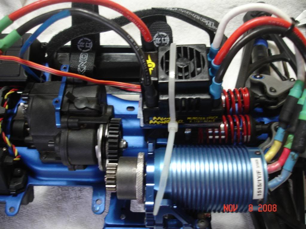

More update:

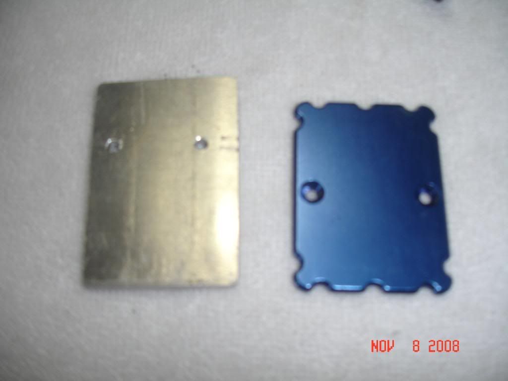

I installed the MMM today. I don't like the TeknoRC mounting position so I fabricated my own mount using 3mm aluminum.
Stock on right side, my creation on the left side:
After it was painted.

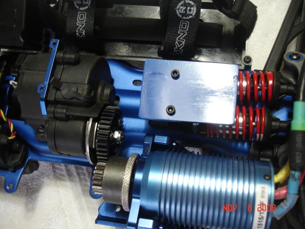

The holes line up with the rear shock mounts. I used 25mm spacers and 2 40mm caphead screws to mount it in place.

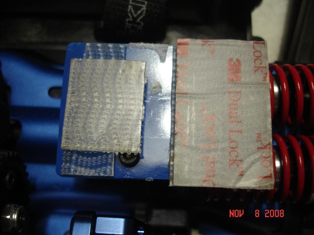

With industrial velcro:
I also lengthened the MMM switch wire:

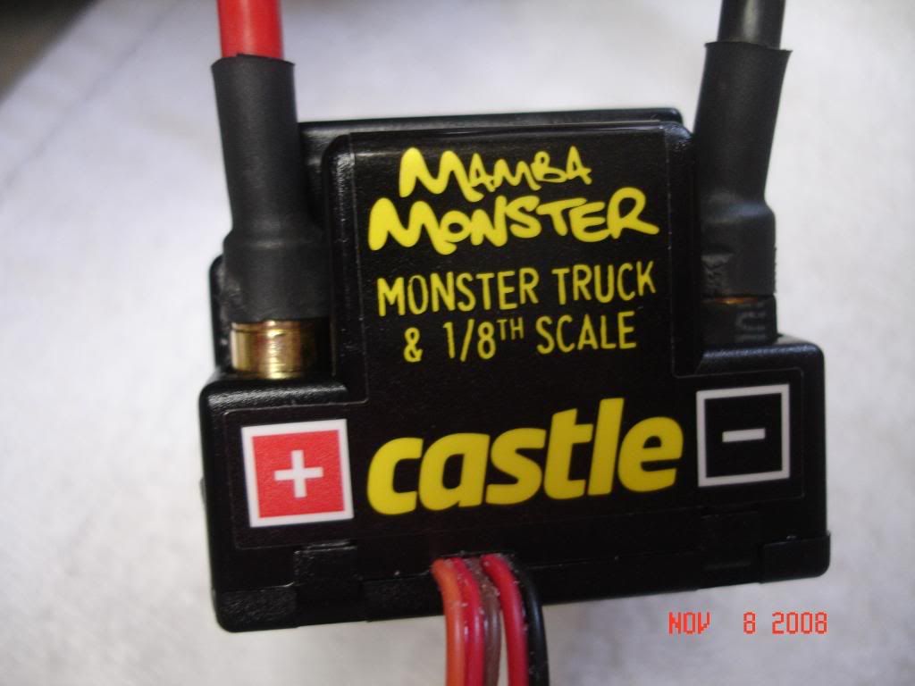

My biggest concern. The positive bullet connector is too close or either touching the heat sink. I can't install a heat shrink around it.
The MMM temporarily mounted on the truck. The ESC sits lower now instead of being on top of the tranny.
