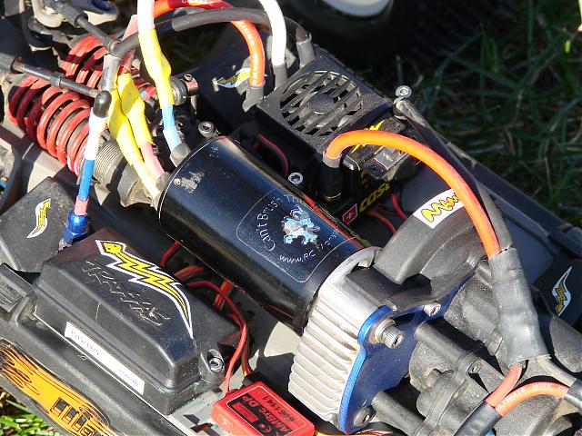

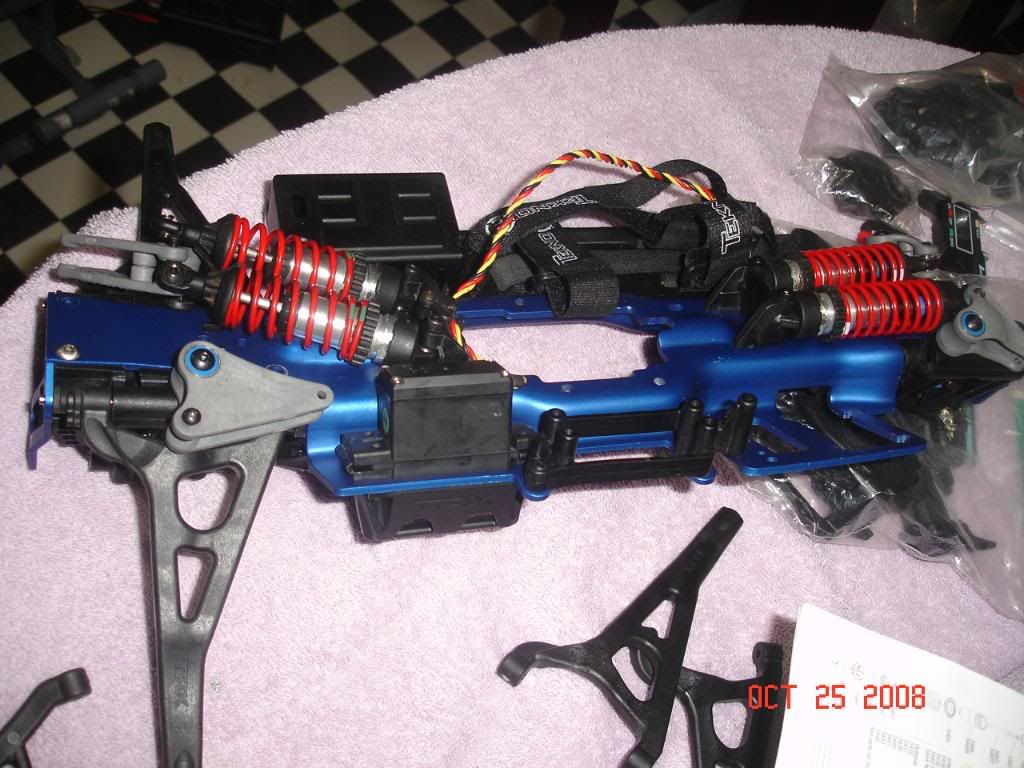

Well, I decided to convert my 2.5R revo into brushless. It will be powered by a Neu 1515 1Y and MMM combo. However, while waiting for the motor to arrive (though I can transfer the TeknoRC Neu 1515 1Y from the gmaxx), I decided to start assembling the truck.
Installed the Tekno RC conversion kit I bought from James (lincpimp):
MMM V3:

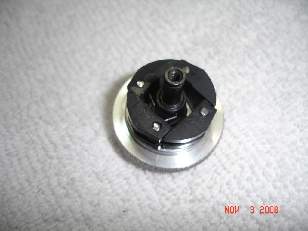

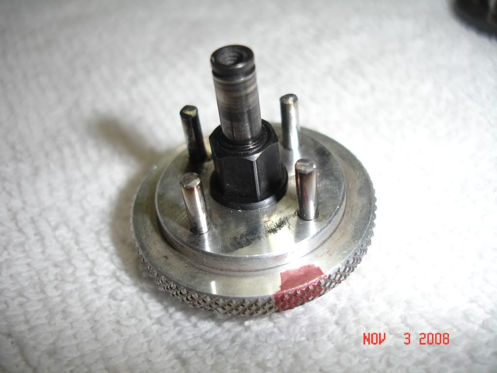

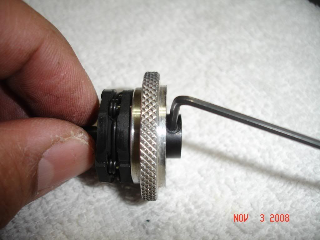

The TeknoRC conversion kit elektri-clutch uses a 2-shoe clutch system. I don't want to run this 2-shoe clutch with a 1515 1Y. Instead, I took out the stock clutch and installed my UE 4-shoe clutch from my supermaxx (retired from bashing and racing duties).
TeknoRC elektri-clutch:

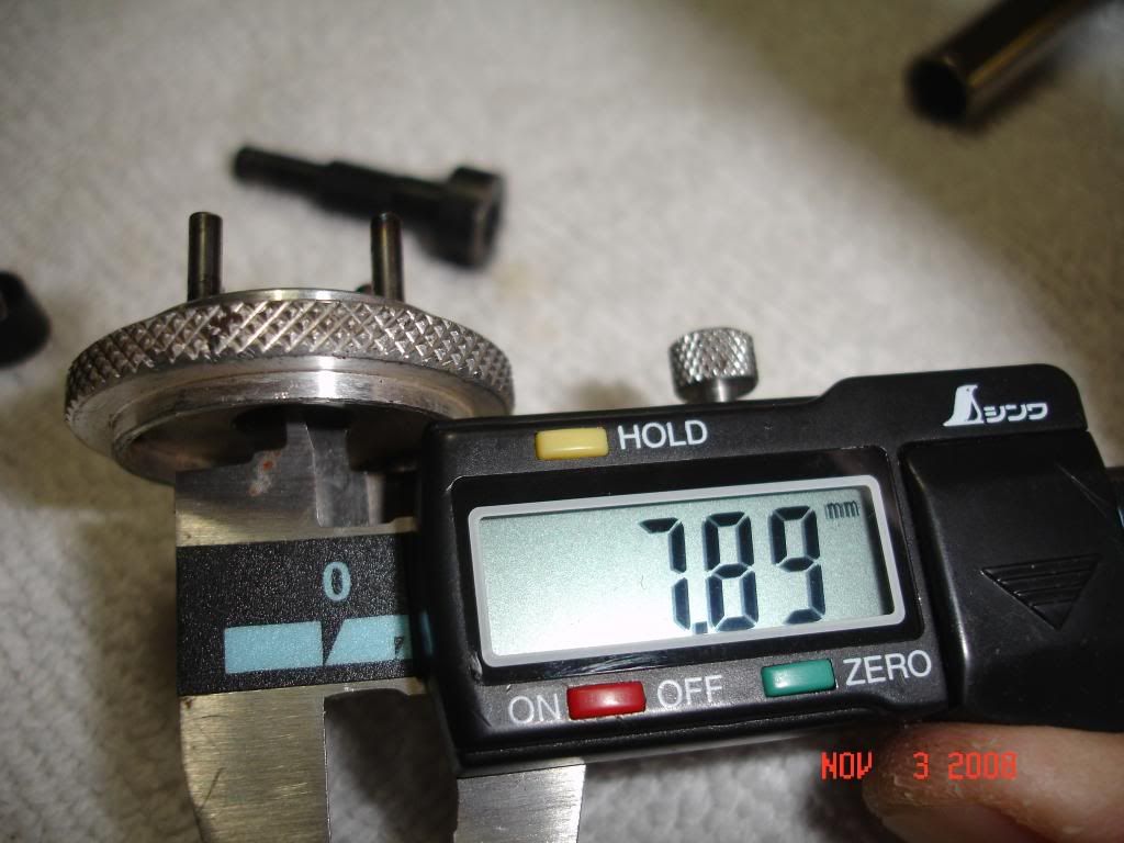

Diameter of the flywheel mounting hole (elektir-clutch):
UE 4-shoe mounting hole diameter:
That's only a difference of .02mm.
Continued on next post

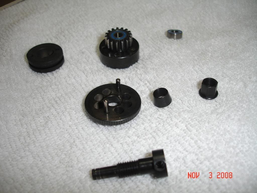

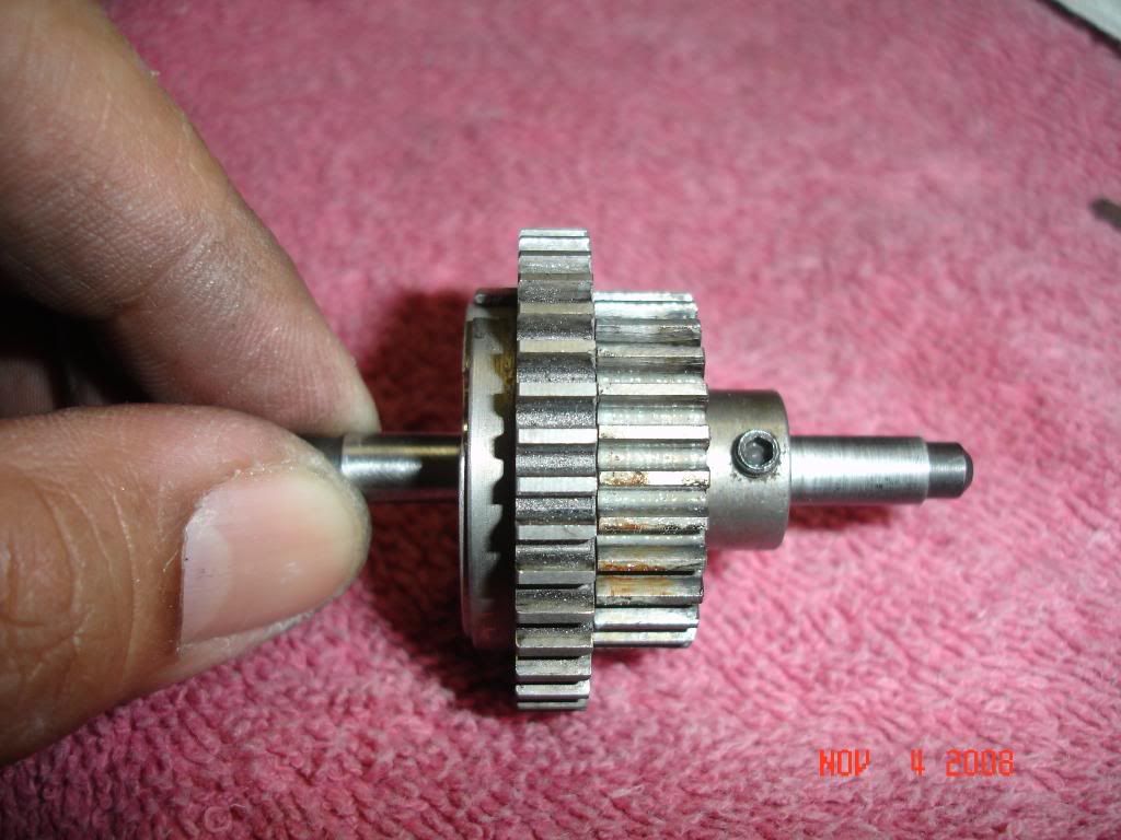

Flywheels side by side:
UE flywheel with the stock clutch nut, elektri-clutch shaft, and collet:
Carbon shoes and .9 springs mounted:
Still plenty of room to access the setscrew:

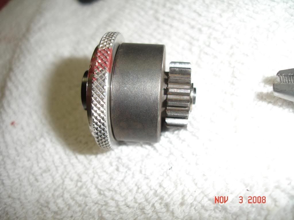

Complete assembly:
Side by side with the stock:
See next

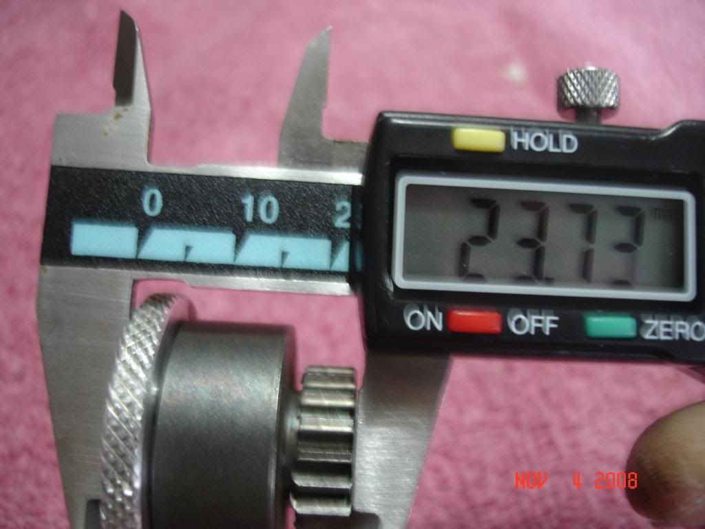

Complete assembly:
Final measurement:
UE 4-shoe clutch, Kyosho 17T narrow CB:
Stock:

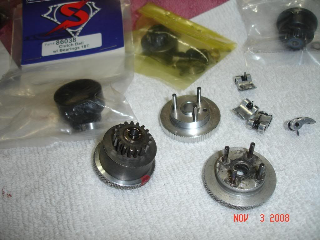

I will be grinding the lip on the 4-shoe flywheel tomorrow. The lip itself is about 2mm so after grinding it off, it will be about the same with the stocker. The UE 4-shoe clutch also used the e-clip just like the stock clutch.
My assortment of clutches/flywheels etc next to the assembled 4-shoe elektri-clutch:

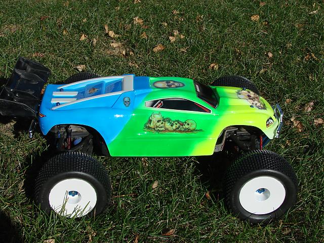

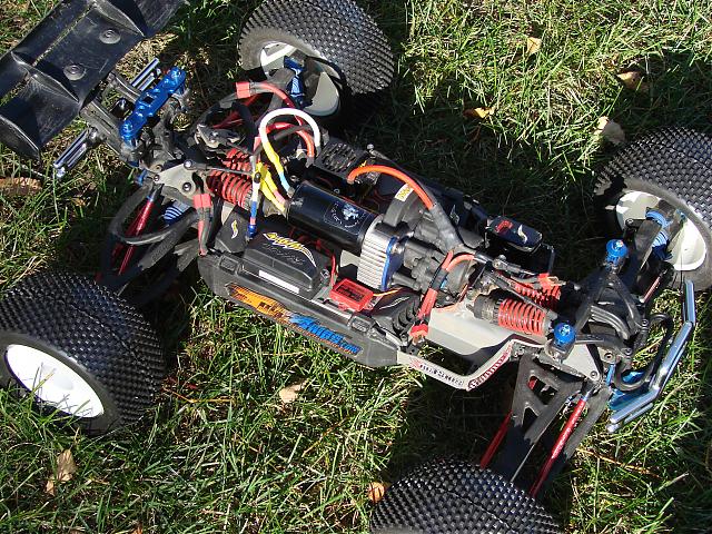

Nice set up. Thinking of same set up for my Muggy. Have 1515-1y & MMM. Talked to R C Monster Mike about Motor mount & Bat tray. He also suggested 1515-3d. Running E-REVO w/ 1515-1y, MMM, 2-7.4 8000 Max Amps lipo, plus other racing mods.
Name:	New  Painted Body on E - REVO 018.jpg

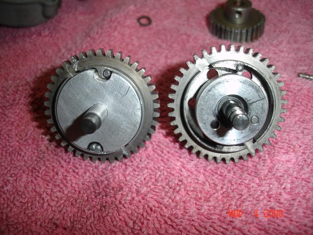

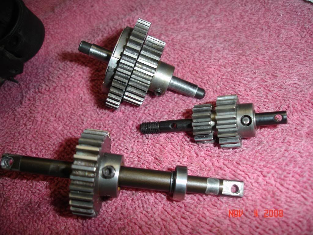

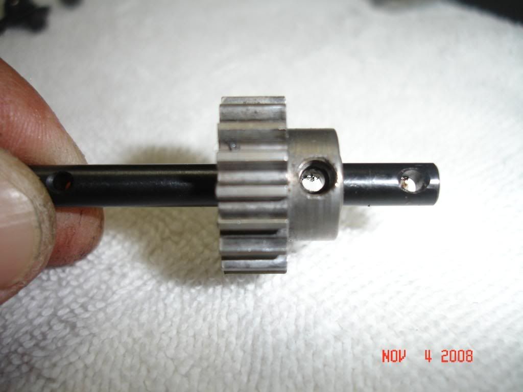

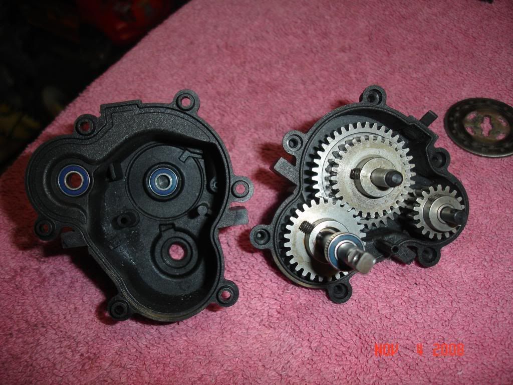

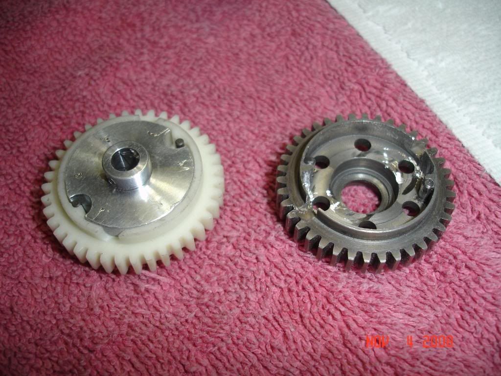

Here are some pictures of the tranny I modified for the brushless revo. I converted the revo 2 speed to a single speed locked in 2nd gear using an adapter plate I bought from Oomp(one of the guys over at traxxas forum).
Single speed adapter plate:
It was designed for the plastic 2nd gear so I have to dremel the RRP 2nd gear to make it fit.
I also drilled the shaft to 2.5mm so I can use a bigger pin(stub axle pin) for added strength:
Side by side with stock RRP:

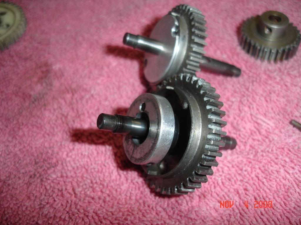

Some more pictures:
1st gear removed:
The assembly:
The top shaft hole was also enlarged to 2.5mm in order for me to use a bigger diameter pin. I used the revo yoke setscrew custom-cut to size.
The flywheel after grinding the lip:
