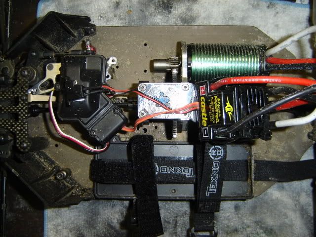

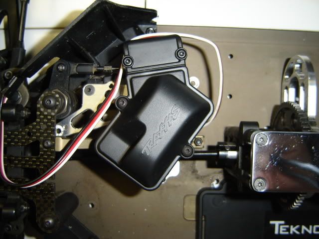

Here is a pic of the ESC mount trimmed down and shined up a bit, also the waterproof emaxx receiver box installed (MMM combo and my 4s lipo on order due here mid this week)
Thanks for the idea Rnemhrd

everything looks good except the battery tray, there is nothing to keep te battery from shifting into the spur, here is my setup but as u found using the 62 spur doent let u get many batt tray placement options, i bought a new era batt tray and modified it for my 5s 5000mah zippy pack, bolted it in for places to the frame for rock solid mount and its nice as the tray has walls up the side to keep the battery in place from side shifting as velcro has give hope this helps

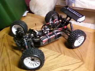

Here's my latest update

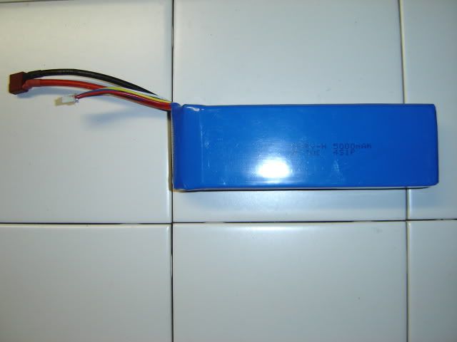

So here is the batt I'm running ... it's the zippy H 5000mah 4s 20-30c

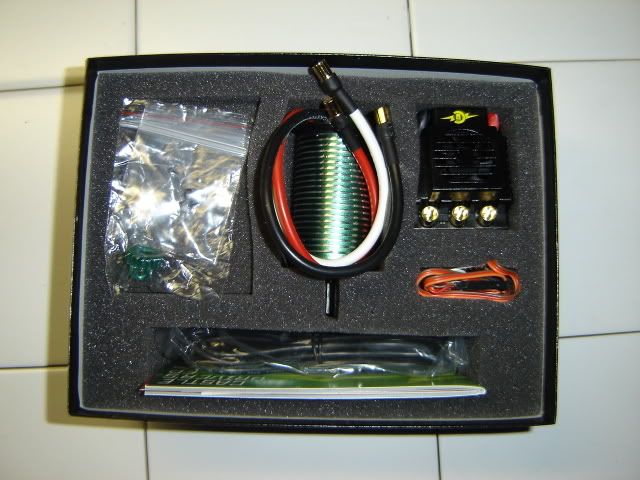

Here is the castle combo as it comes from the factory

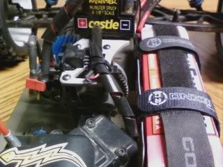

Here is everything mounted up, obviously I took this pic AFTER the test run. It has the tekno dual shank pinion on right now beacause my loctite didn't hold and the RCM pinion went flying :D

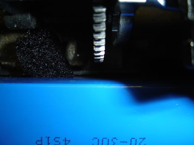

And here is the clearence for my batt, with the tray mounted more forward and outward with the 62T spur gear on atm. I just changed it to the 52T ofna hyper st pro truggy center diff which leaves a lot more room for the batt..
