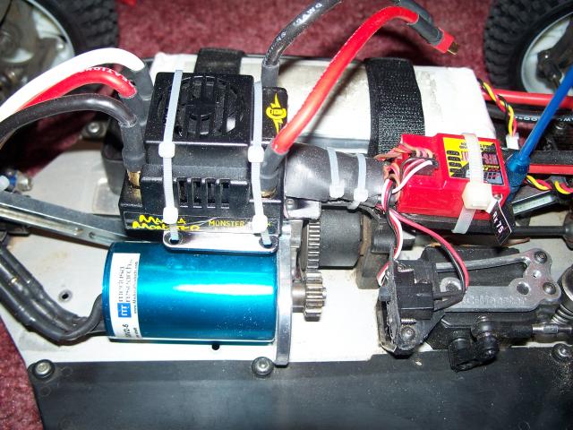

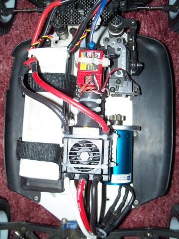

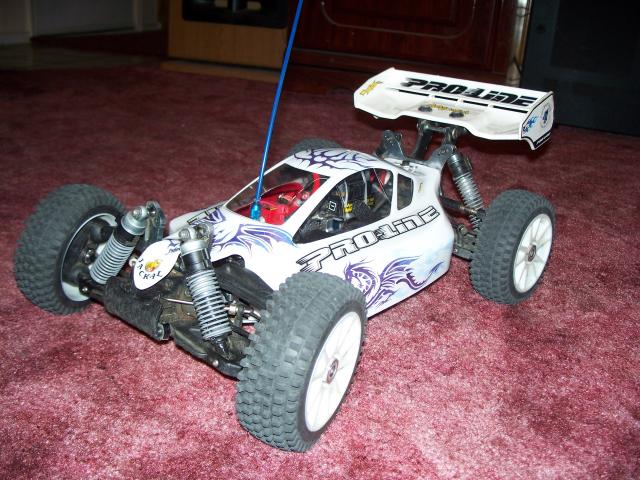

I'm thinking the medusa+ mmm esc is one bad azz setup.My buggy on that combo is AWESOME on 4s .No b.s.
