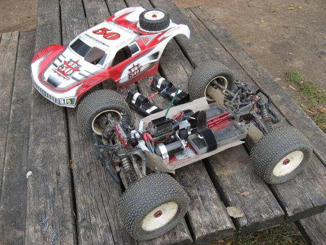

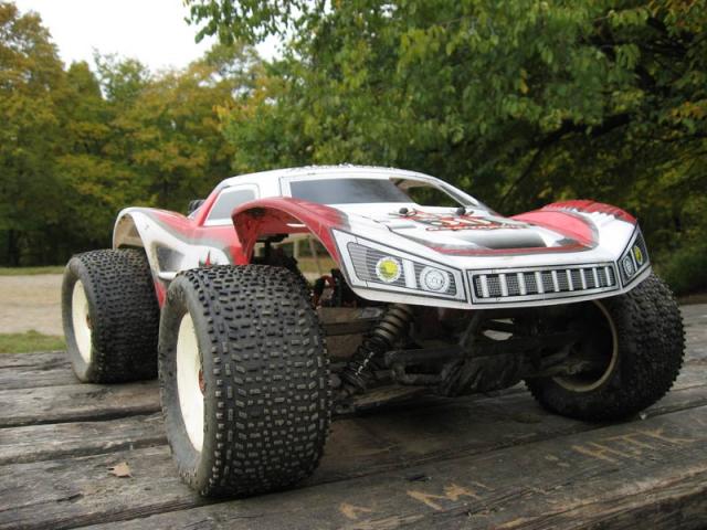

I am still lovin' the look of the BR50 trophy truck body but underneath it i'm now running the Mantis truggy chassis with truggy tires as my bash spot sort of "requires" more than buggy tires.
Electric components (Neu 1515/1100kv motor, Jazz 55-20-32 ESC and 10s1p A123 cells) and chassis layout remained nearly unchanged. I'm finally using a proper custom aluminium motor mount which enables me to run without "backup" fans over the motor since it can now dissipate heat over a rear mounted aluminum "clamp" to the chassis which acts like a big heatsink. A second big plus of this type of motor mount is that gear mesh of the pinion and spur always remains perfect. I never have to retighten my pinion as i had to with the old motor mount.o

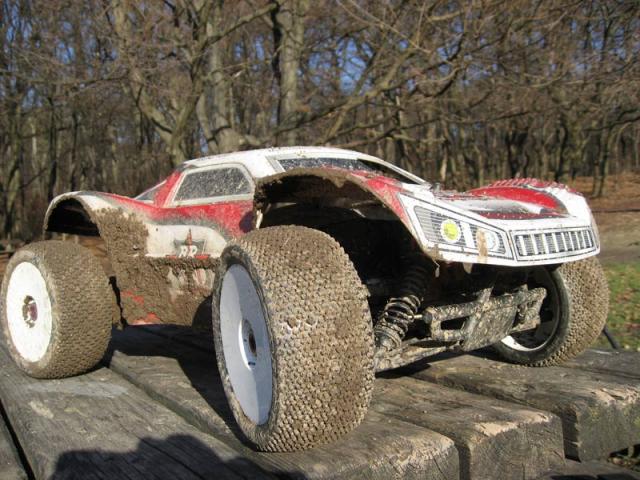

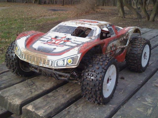

Proline Badlands: cut to fit Proline VTR wheels and using AKA truggy inserts
Here is a video of this test run
. There is a big improvement when it comes to wheelies and ballooning compared too standard mounted badland tires.
. Handling is more precise especially while cornering at high speed. Forward bite remains unchanged and is "beastlyl" on grass.
. Definitively one of my favorite tire set

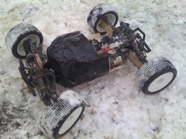

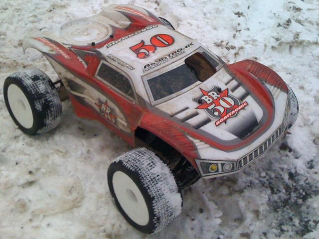

And for completion: a few days ago after snow has fallen i improvised and made a basic chassis protection to be able to run on snow without worrying too much about the electric components.
Basic chassis protection (quick and dirty made out of duct tape)
AKA City Block mounted on half offset rims
. Sorry no time for videotaping this testrun.
. Off course you would't expect much grip from a rubber tire when running on hard packed snow. And there was no grip ;-) Nonetheless it was fun too watch the snow roosters behind the car when accelerating, making speed passes over the bumps and powersliding.
. Half offset makes the car definitively too wide.

12.29.2009, 07:09 PM
I like the looks of this one the best by far:
Looks mean. And the Robotronics body seems to complement those type of tires much better than Slash bodies or the like. I think the fender shape makes all the difference...

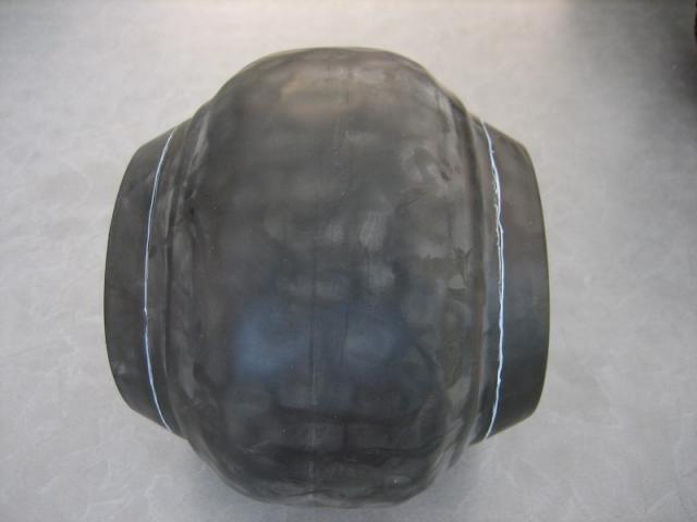

You will need:
. Proline Badland Tires
. Proline VTR Truggy Rims
. AKA truggy inserts
Cut of 15-16mm from each sidewall of your badland tires.
picture from Ron2 (offroad-cult)
Place the aka inserts inside your tires. Fit them over the rim. It's a tight fit. And glue your tires on the rim. And your done.
