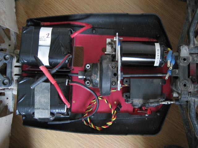

I then removed the truggy axles from the truggy chassis plate and replaced them with the BR50 axles. I'm still using a Neu 1515/2Y (1100kv) motor, Kontronik Jazz 55 ESC and 9s1p A123 batteries to power my 1:8 conversions.
5s1p pack at the rear, receiver and BEC box beside the centerdiff and servo with Eagletree logger on top of it at the front of the car
The other side shows the front mounted Neu 1515 motor and the other A123 pack in 4s1p configuration at the rear. The ESc is ziptied between motor and servo on a separate plate which is mounted between front axle and center diff

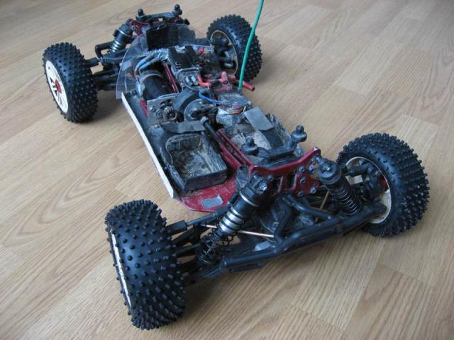

I obviously had to do something against all the mud and stuff getting inside. Well, after some few hours tooling around with my dremel and parts i had laying around the car was ready for its second maiden. But by then a fairly huge amount of snow had fallen, so i had to run the BR50 on asphalt still very wet and partly covered with snow.
Here you go: Part 1 of the video and part 2 of the video
Not a lot of grip but nice power slides and roosters behind the car.
This time the car was covered with wet snow and wheighed a "ton" when lifted from the ground.
Showing with what i came up to protect the electric components from the elements
It worked out alright, but still some snow had protuded the front as i only had glued some lexan parts to the chassis. Lesson learned. Has to be screwed to the chassis. No wonder there ... i made some shortcuts to get her to run on that day.
Here is the eagleetree Graph of 1 minute of this run (basicly the first part of the video)
. The temperature readings can be ignored. After the run the motor was cold. But it took me atleast 2 minutes to get the body and protection off the car.
. On average 16,5A (412 Watt)
. Peak amps are hovering between 40-55A while accelerating. Power peak at 1331 Watt. Those number will rise with grip.
. Max 26500rpm as i really couldn't hold full speed for a long time. Place is too small and it was too wet.
. The car needed 276mAh for 1 minute. Runtime calculates to a little over 7 minutes with 2000mAh.

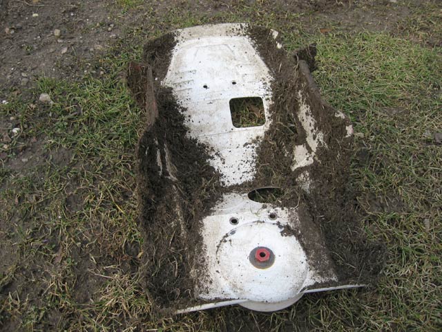

Peak Amp draw hovered between 50-65A (around 1250-1500 Watt) while accelerating with a short burst at 85A (1760 Watt).
I'm now facing a new challenge. The body gets very heavy while driving on wet grass.

02.14.2009, 06:05 PM
Sweet vid, that thing handles very very well, and so quiet too.
On the mud front, seems like you need some form of mudguards over the tires (but inside the shell) to deflect all the dirt that is kicked up. Shouldnt be to difficult to make something suitable using some thin lexan off cuts and shoe-goo...

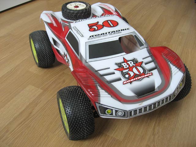

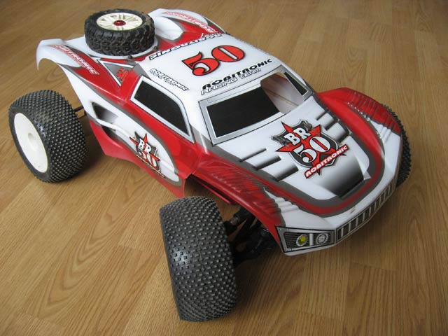

I wasn't too happy with the appearance of this truck with those small buggy tires. I therefore fitted truggy tires to the BR50 Chassis. Crimefighters LPR with half offset seemed to be the most pleasing choice.
I made some preliminary test runs without body (Body had to be trimmed somewhat)
. video on snow
. video on asphalt
Eventhough those runs did not show how the chassis would perform with grip i decided to trim the body to fit the bigger truggy wheels.
I had to wait a week to run the modified BR50 on gras (without snow). Well as good as it looks, the track width is still to narrow to make it corner properly without tipping over.
. video on grass
I therefore decided to mount the BR50 body on the Robitronic Mantis truggy Chassis (with truggy arms).
First off i mounted crimefighter tires with standard offset and made a similar test run.
. video on grass with truggy chassis and standard offset truggy tires
Those tires had less grip due to their harder XTR compound. No tipping over due to lesser grip and a wider track width.
To get even more track width i mounted my half offset crimefighter tires
. video on grass with truggy chassis and half offset tires
To complete this test series. I made a short run with the BR50 chassis and buggy pin tires.
. video on grass with buggy tires
With buggy tires the car felt more agressive and accelerated better without wheelie tendencies (tires had better grip level). I used a 15t pinion with truggy tires and an 18t pinion with the buggy tires to compensate tire diameter. The narrow track width of the original BR50 chassis is tricky at good grip level and the car might tip over when cornering: less agressive tires should be a better fit. When it comes to its appearence i prefer the look with bigger truggy tires. But even with half offset truggy tires the BR50 chassis is to narrow to get good cornering without tipping over. It's then more suited for fun driving. Truggy tires seem only to work when combined with the wider truggy chassis (with truggy arms).
I will extend my tests when snow has melted completly around my place. My eagletree logger measured power peaks around 1900 Watt (80 Amps) with truggy tires and around 1500 Watt (63 Amps) with buggy tires. Average Watts (450W as oposed to 360W) were higher with truggy tires.

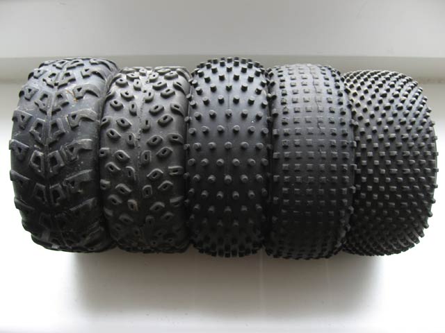

The only thing that bothered me (aside from appearence) while driving the BR50 with buggy tires was its tendency to tip over when cornernering too fast. After another test with my buggy and the same pin tires i can safely say it was primarely due to the agressive tipe of tire thread as my buggy also had tendencys to tip over while cornering: buggy video. There is no tip over on this vid but before i shot this video i managed to tip over the protos buggy too.
br50 chassis with old Mugen pin tires mounted (very agressive tire thread)
This is my buggy tire selection
Sometimes less grip is just easier to drive. That is why i now run my buggy with axial cubes tires. Tire on the right side. They are the smallest one and do look awefull on the br50 chassis with body mounted. But they give good performance.
