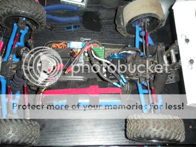

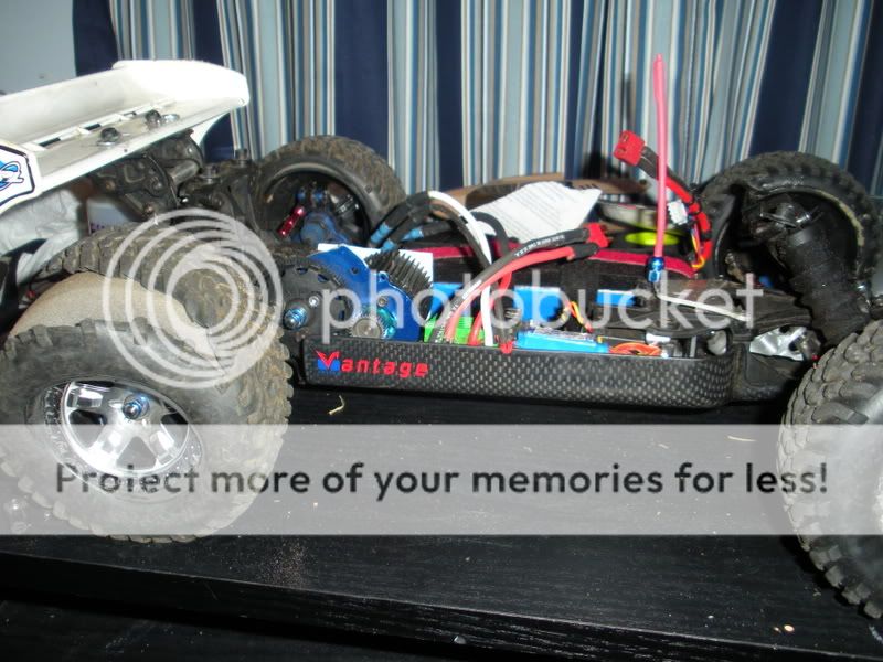

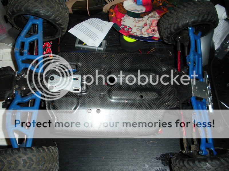

Here is the Updated Jato, I got the Vantage chassis had to change everything around.. The weight balance isn't that bad but its still not perfect.. This thing is stupid it destroyed my tires.. I also got my Big bores for my Slash Finally. Had to order another set because the first ones never showed up.

Idk If you can tell but in all the Pics there is a BEC right next to the MM its right on the case.. It was just the crazy stupid gearing.. And the starting power I was and other settings where crazy.. 47t/76t gearing huge tires and a small ratio in the Tranny.. Locked in 2nd..

Yes I did remove it, You where running 16/40 = 2.5 ratio.. I was running a 47/76= 1.61
Not to count my Internal ratios are alot higher..I might pick up a set of those tires.. But I Will probably be getting Badlands on Buggy tires and throw them on for Bashing.. Just trying to have fun with it..

Yea I got buggy tires on it now, That was basically the only spot I could even put the battery, It wouldn't fit length wise and it fits perfect in that spot. Yes it is a BIT off balance but it isn't to bad...
